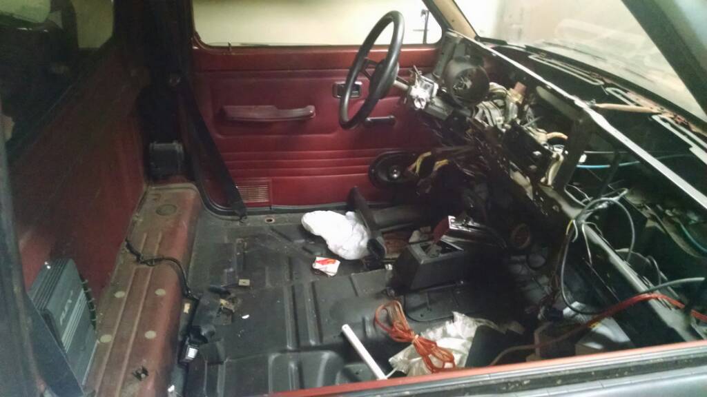

Just a little update,

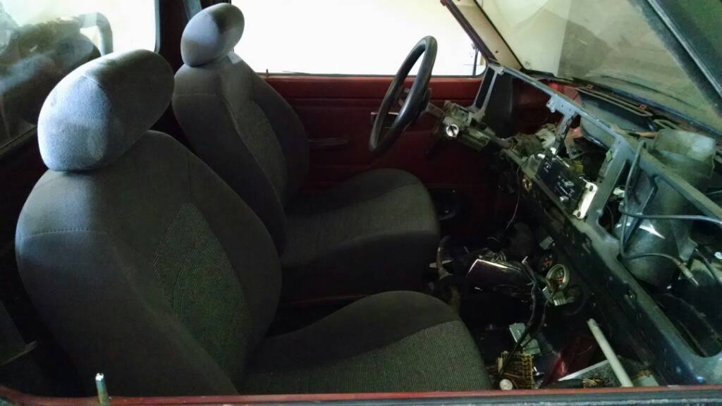

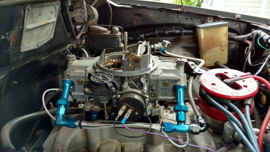

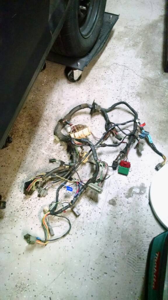

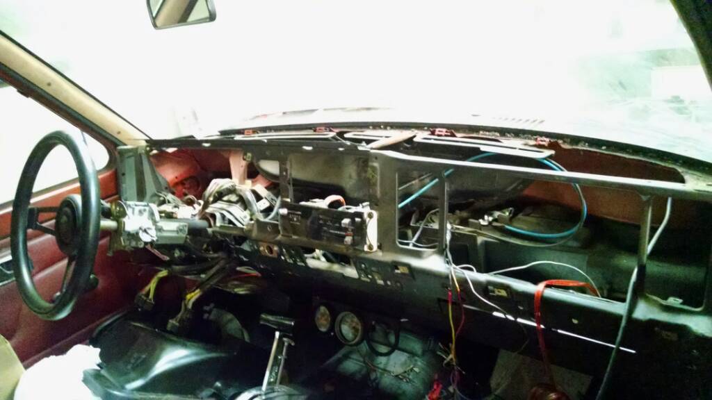

Added a 130amp 3g alternator, started rewiring the truck, picked up seats from a zx2 escort but got tracks out of a 89 ranger that didn't bolt up so need to figure that out. Also ran a full an fuel system.
Sent from my XT1080 using Tapatalk
Update;

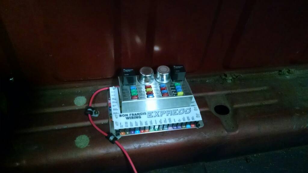

I'll forget most of it, but the fuel system is done, wiring it is nearly finished...didn't wire wipers or heat because it's not needed for test and tune nights.

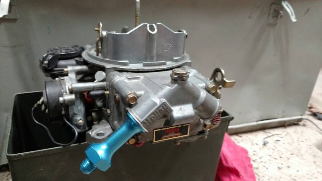

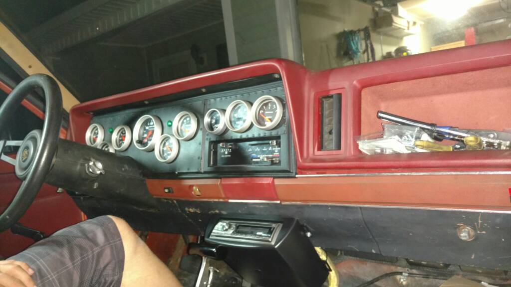

Got the driver side seat in, need to fab a passenger seat bracket. Put in hood pins, rebuilt the Holley 670 carb (73/68 jets with a green diaphragm) and am nearly ready to fire it up.

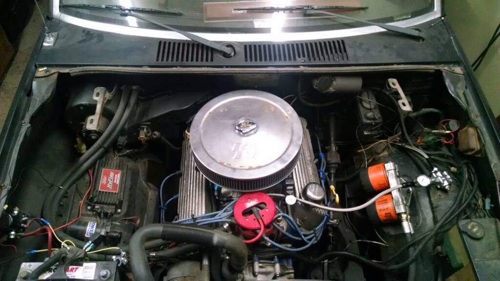

IT RUNS!!
