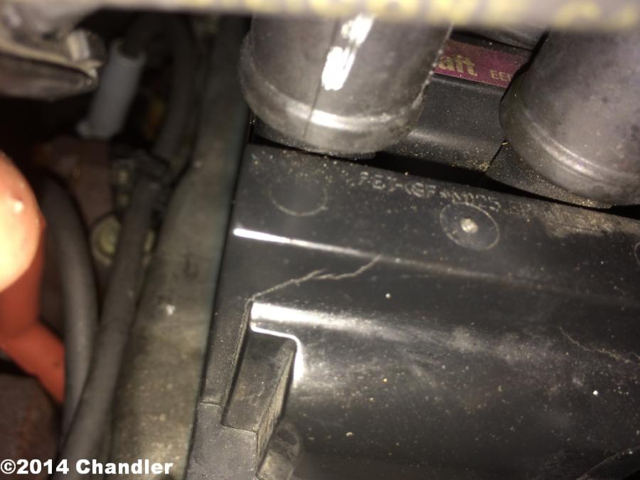

I had a similar problem with rough running, stumbling, and backfiring on my truck. In my case, it was microscopic cracks in the casing of the ignition coil. The coil looked good at a glance, but under my pocket microscope it was clear as day. Incidentally, driving around on a broken coil for so long had burned up all my exhaust valves, and so a tear-down and trip to the machine shop was necessary.

...I had a similar problem with rough running, stumbling, and backfiring on my truck. In my case, it was microscopic cracks in the casing of the ignition coil. The coil looked good at a glance, but under my pocket microscope it was clear as day. ...
You mean like this? It looks like a scratch to me.

I took a close look at the coil pack with a high power magnifying glass. Those are indeed cracks in the casing of the coil pack. Funny, it tested fine with OTC HEI spark testers.

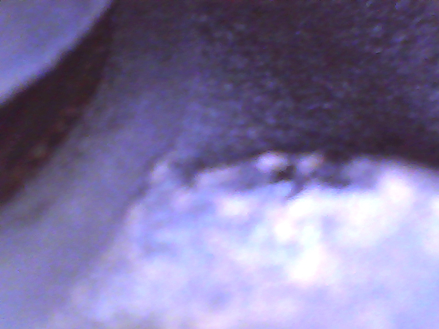

I also looked into Cyl-4 with my borescope. I think I got a picture of the exaust valve wich was open. The picture is out of focus and up-side down (possibly mirrored as well). I had to take video then capture an image. There is a bunch of carbon buildup, even after 3 fuel treatments. I'll give it a nice long drive after it is fixed.
