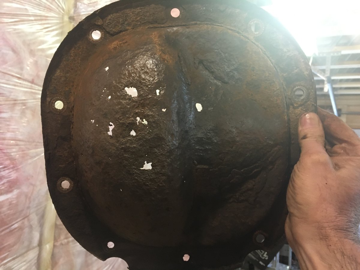

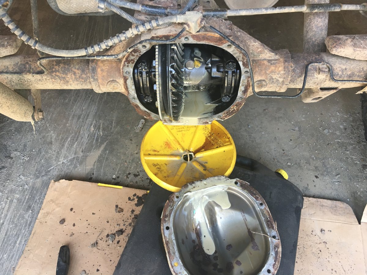

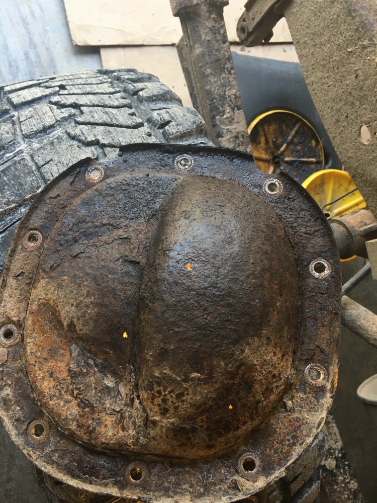

Was doing some servicing to the fleet, it was boot’s turn. Rear diff cover was leaking so I thought I’d pull it off and put fresh silicone on and refill it…

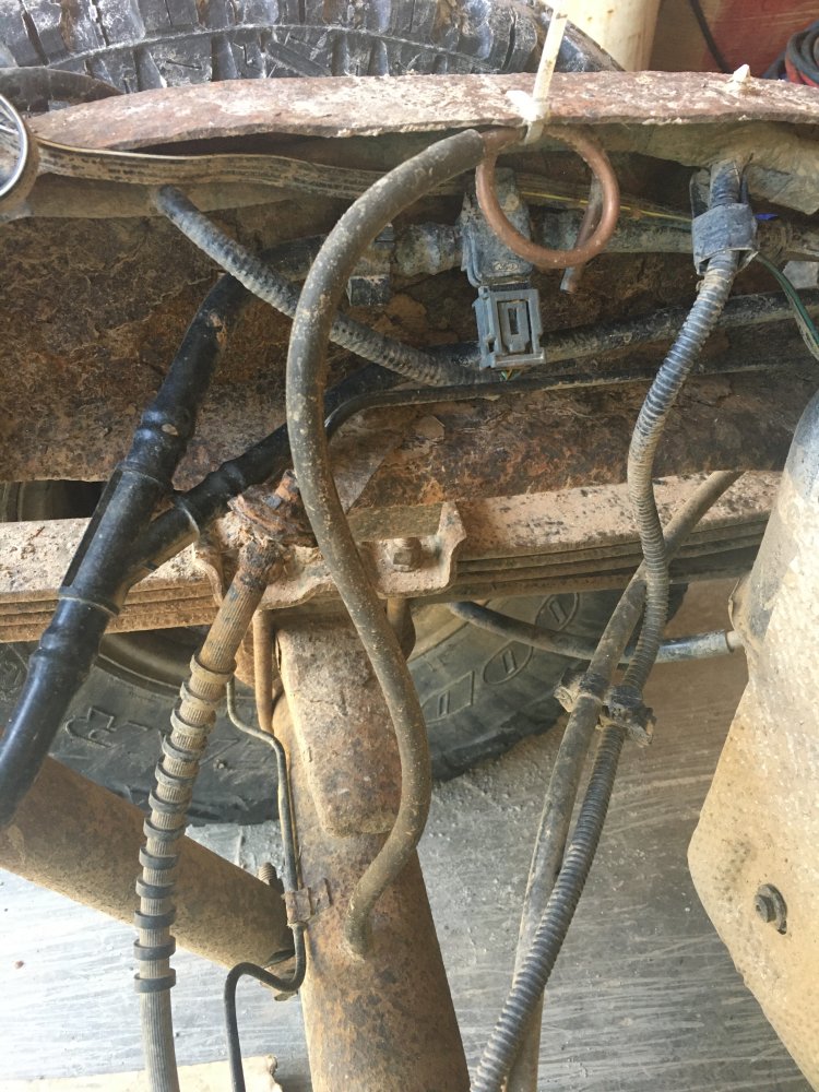

Pulled it off and there was water in the oil, that’s weird since I extended the vent up to the frame and put a couple loops in the copper line.

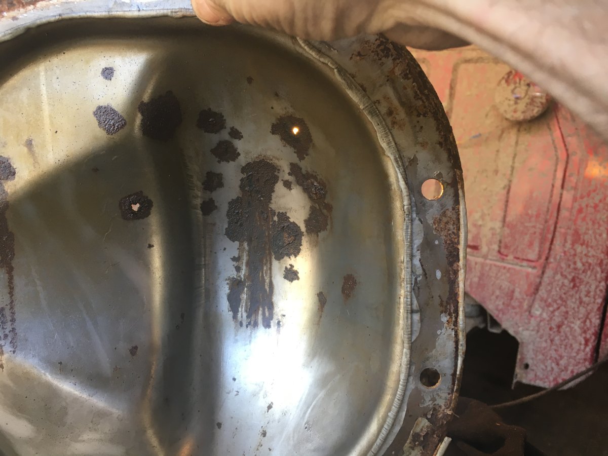

Then I saw the holes in the cover!!
There were a couple big holes, but 22 tiny rust holes!

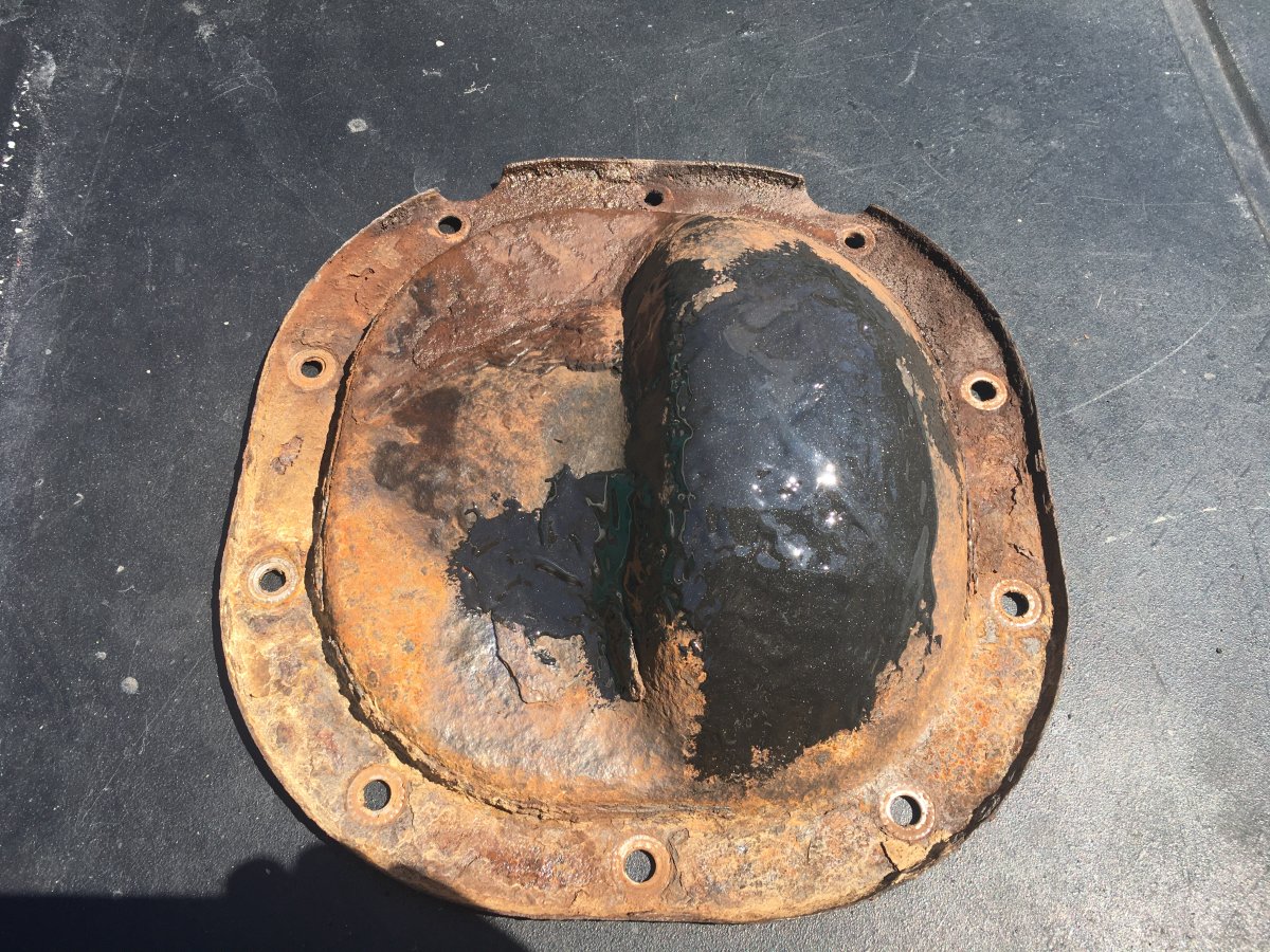

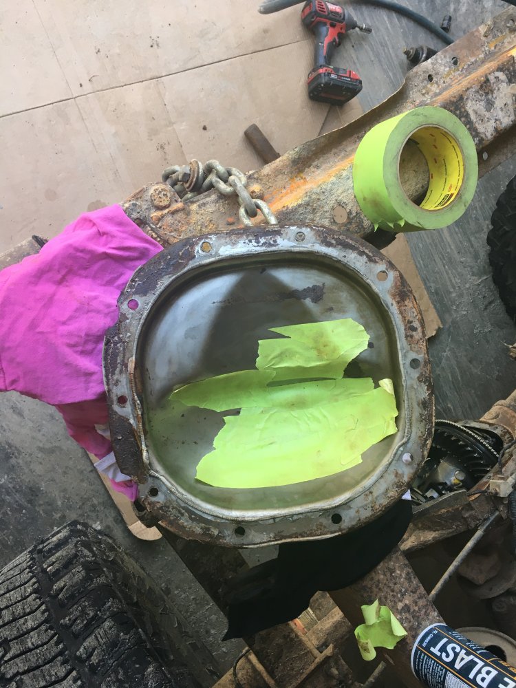

Cleaned the inside with rags and wire wheeled the outside.
Taped up the inside and slathered the JB weld on the outside.

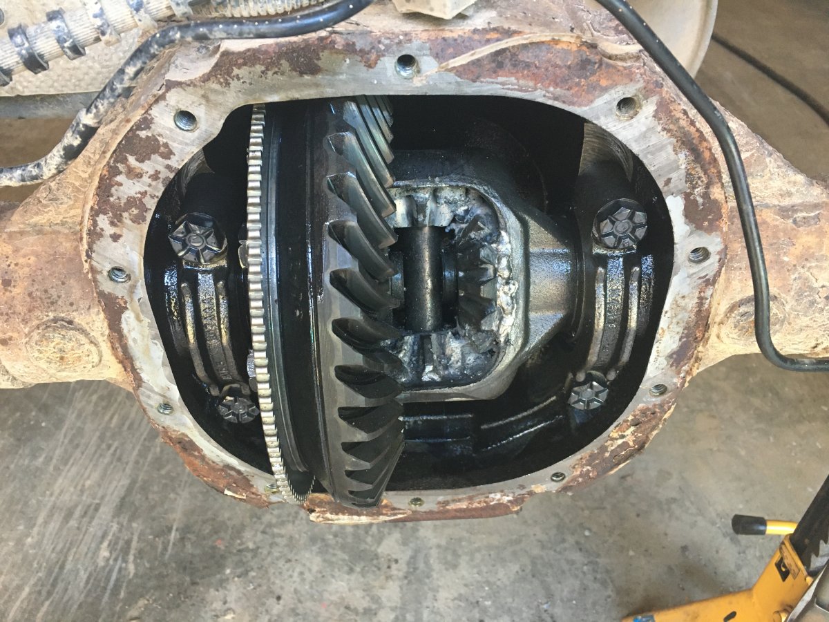

When I first got boots I thought it had a limited slip because it would spin both tires. It started spinning one more and more and pulling the cover revealed an open diff🤬
So…. Lincoln welder to the rescue!!
