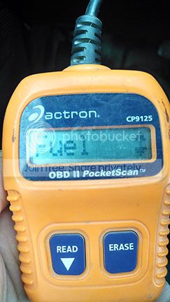

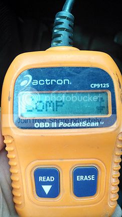

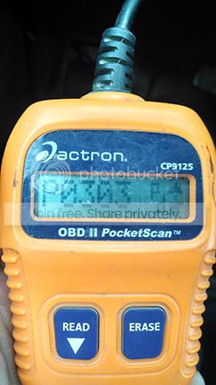

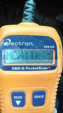

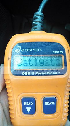

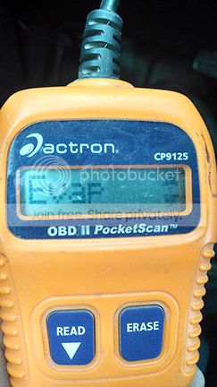

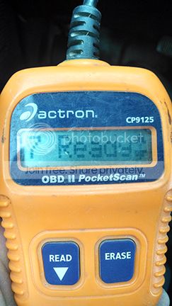

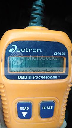

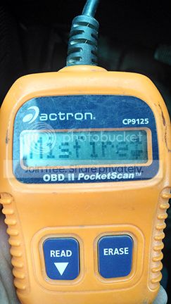

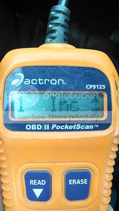

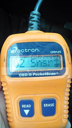

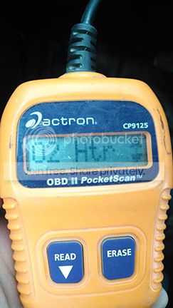

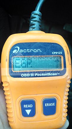

well i tried it and no issues at all. got home, just for the hell of it i hooked up my dads obd2 scanner. the light went off so fast i didnt think there would be a code saved. but there was luckily.
p0303. had a bunch of crap come up with his scanner. will post the pics.

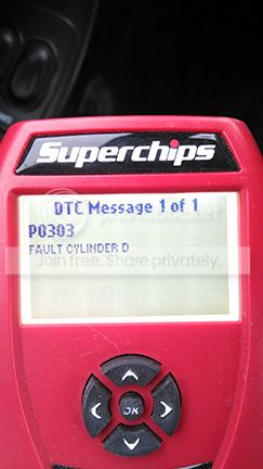

then scanned with my superchips tuner, same code #, but it said "Fault Cylinder D" rather than all the crap my dads scanner read.
guess its a good thing i have plugs and wires ready to go.
just something weirds me out about how it stuck at 5k rpm and would react to letting off the throttle, or anything.
i think their in order

All that from my dads scanner. i did not clear the code

cleared it, went for a 15 minute drive, cruising speed, getting the rpm's up etc. didnt come back and didnt experience the bucking. will get the new plugs/wires installed asap and go from there i guess.
Honestly didnt think a code would have been saved. guess i didnt need to make this thread after all!

That hand scanner won't get transmission codes.
A P0303 is a cylinder #3 misfire.
P0300 is misfire detected
P0301 is cylinder #1 misfire (last digit being cyl #)
Just an FYI.
As adsm08 said, you will need a better scan tool. Your description sure sounds more like a transmission issue. Possibly stuck in passing gear with the TTC locked for what ever reason, I dunno.... Just get the TCM read, then get back to us.
