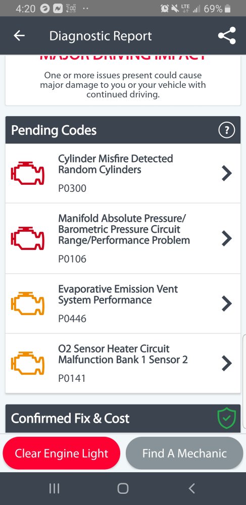

Ok guys need more help.
Replaced mass air flow sensor....runs *ok* (but weak) till about 3500-4k. Then it starts missing to beat all hell, runs like total shit, etc. If i keep the hammer down all it does is wanna stall, if i let off it returns to normal at idle.
No check engine besides the blinking for missfire but i scanned it anyways...
05 Cobalt help needed
The other code did mention the MAP, wondering if that is what was bad instead of the MAF?
Any input??
Any input??
