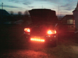

nice lookin truck man! I honestly like all the lighting, I think it gives a more custom and unique look to a truck. Do you have lights around your front license plate? In your avatar it looks like you do, never seen that before and thought it looked cool, can you get some close-ups pics on how you have that set up? Do you have it hooked to your running lights so when you turn them on the license plate lights come on? I think that looks really cool and am interested!:icon_thumby:

Hey man thanks! Oh yes... I have more lights on the front than that now, haha. The lights on the front of the pickup are ran to a relay in the engine bay, and the relay is switched by the parking lights. The lights on my toolbox are just hooked up to the running light wire on the trailer brake controller.
Here's some pictures, I can get more if you want them!
Thanks! :icon_thumby:
The lights are just mounted to the licence plate bracket using a couple old licence plate frames, works quite well!

dude that is SICK! I may try something like this on mine.
Thanks man! I'm quite pleased with it. The only thing I would do to mount the lights is just use a long metal tube, that way most of the wires can be hidden inside the tube instead of using wire loom... I'd also use simply three of those 3-light ID Bars, keeps everything more compact that way.
