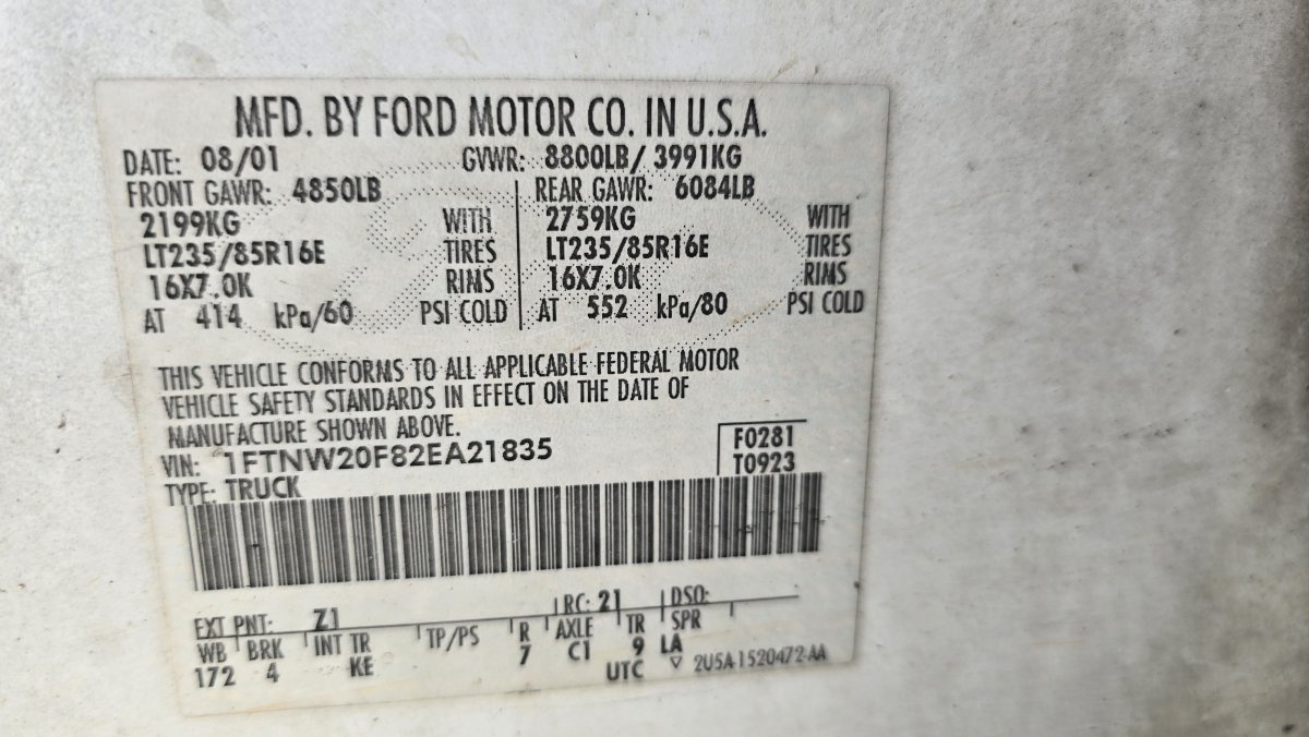

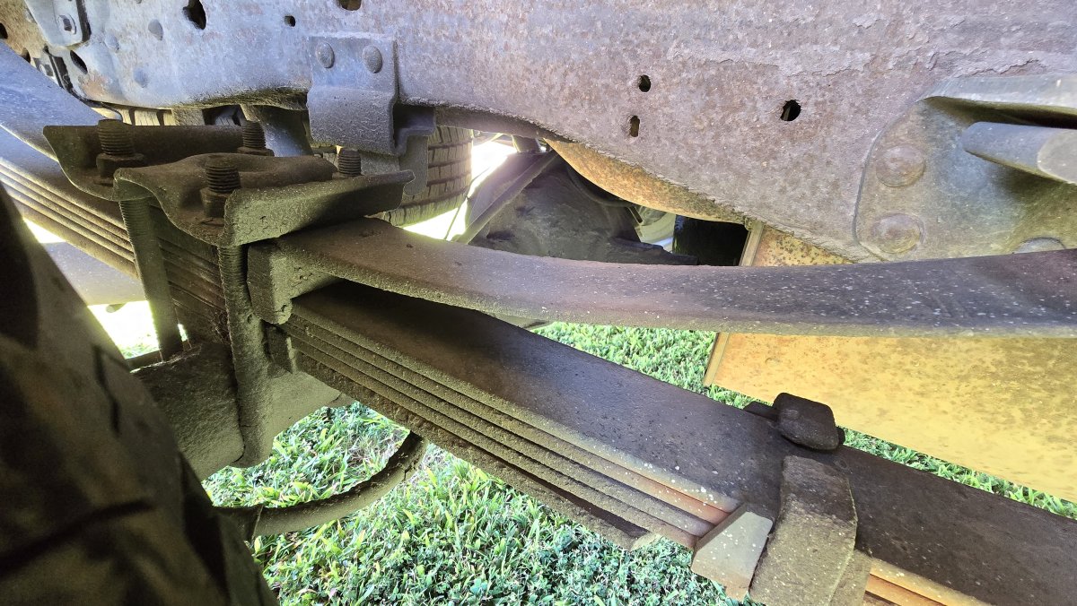

Just to give a little more data to the mix, my 2002 F250 superduty has helper springs. I haven't had it weighed. But Google says curb weight is between 5870 and 6484 lbs. Being a crew cab and long bed, I'll bet on it being toward the high side of those numbers.
