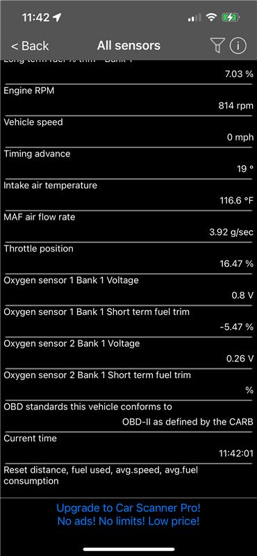

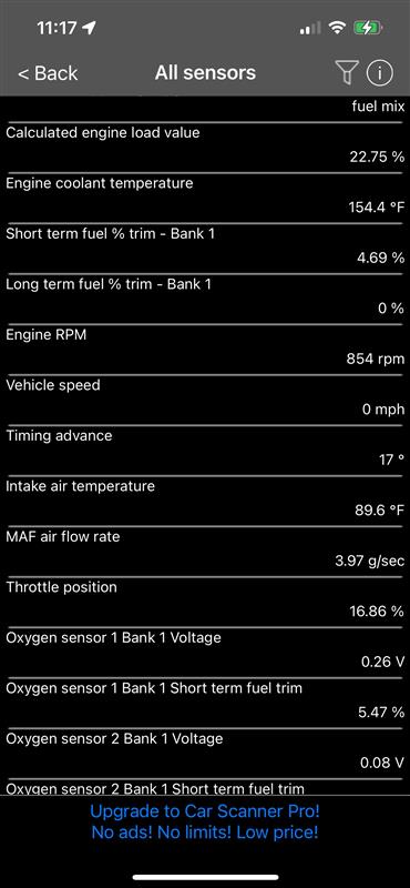

Have you watched live data? What is the fuel trim value showing at various operating conditions if it will stay running? Say at idle, 25mph, 35mph 45mph and 55mph just to cover the spectrum of some operating conditions. That should give an idea of how far off it thinks it is on fueling at least. I wouldn't be too surprised if the oxygen sensor could be bad too (that I'd think is safe to change, they're a wear item unlike most sensors)

Funny you mention that, I am now starting to track these conditions. I should mention that both o2 sensors are roughly 2 years old. Right now, I've only been able to drive it around the neighborhood a few times and have not experienced any issues at all. I did notice however that "O2 Sensor 2 Bank 1 Short Term Fuel Trim" is not registering any % (see image). It seems to have voltage. It has also showed as "n/a%" Additionally, I am getting approx a 10% swing from -5% to +5% on "O2 Sensor 1 Bank 1 Short Term Fuel Trim". Is that normal?
Granted these are all on normal operating conditions. I have not been able to replicate the poor driving and stalling conditions since Monday night. But I have not taken it on the freeway.
Appreciate your help with this!
Other than the MAF flow rate being higher than I've heard it should be (I have very little experience looking at this so yeah...) nothing looks out of wack there... Usually there's not a fuel trim for the post cat O2 sensor, it's just a monitor for the catalyst to make sure it is working.
