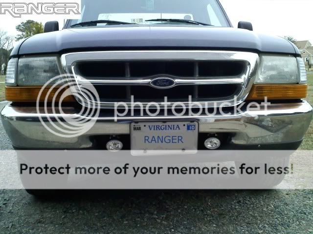

Does anyone have any custom, or non-custom towhooks for their 2wd rangers that didn't come equipped with them. I would like to make some or get some made for my ranger because it currently doesn't have any safe, strong ways of attaching a tow rope to the front. This is my bumper/valence setup and I realize my driving lights might be in the way of potential tow hooks. Please post pics of any custom towhooks you have for the front of your ranger.

I thought about a front receiver hitch, but I don't really wanna spend that much money just for a front tow point, although I might eventually get one. I currently just wrap my tow strap around the bumper in between the bottom of the grill and the opening where the valence is. This probably isnt very strong and its a real pain the @$$ trying to get the strap wrapped around. Will that write up for 93-97 work for my 2000, or are the front frames and bumper mounts different which would require me to get the 4x4 cross member as mentioned above?
I took the tow hooks off a 05 f250 and bolted them to frame work great on b2 but like you said the lights will have to go or be moved
yea im not too worried about the lights, they were 17 bucks from wolly world and I can always move them or take them off. Did you put the 250 hooks on a ranger like mine or a bronco II? Sorry I see now it says b2, my bad.
Can someone tell me more about installing a 4x4 crossmember. Is it located right behind the bumper and is it something I could easily pull from a junkyard. I studied my bumper mounts and frame today and I don't see anyway you could use normal towhooks with my current setup, so the 4wd crossmember might be the way to go.

i picked up a pair of ten dollar 10,000# reese branded hooks from tractor supply and drilled a couple of holes in the frame rail, and bolted them on.
