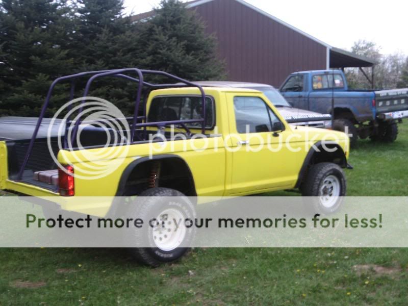

and I just picked up this

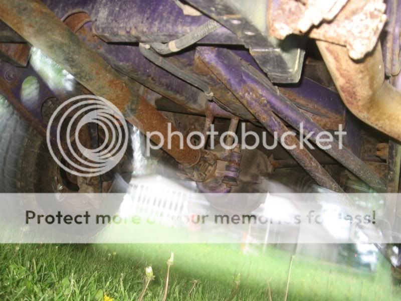

Its a 85 with a turbo 2.3, built C4, 8.8 with 4.30 and alburn LSD, Fox 2.0 coil overs.

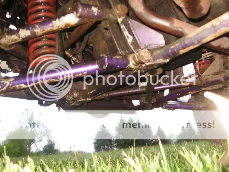

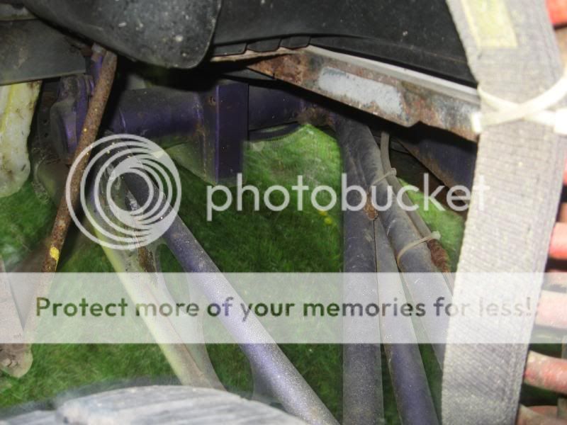

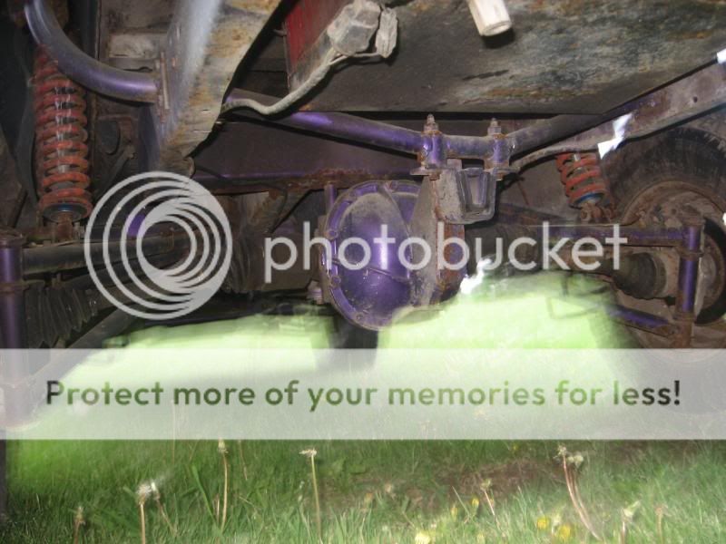

Heres the custom rear suspenion.

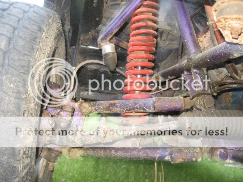

Front suspenion

Looks good, but I think somebody could have used a color other than purple...
I bet they spent A LOT of time designing and making both the front and rear suspension. Looks like the front got converted to A-arm, not TIB.
IRS?? why would someone do that to that truck? interesting
Is it just me, or does it look like the shocks in the back are bending the bar they are attached too?
Thats from my camra it was acting wried. The front arms are custom but it uses ranger hubs and brakes. the steering rack is out of a 94 probe

SO what are the plans for it?? Silver lake runner? Looks pretty neat.
