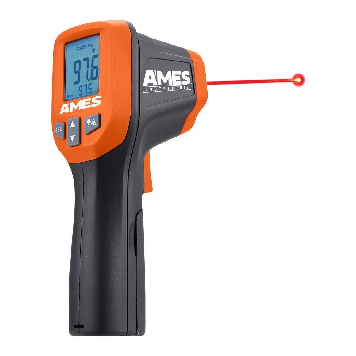

Around town overheating is a airflow problem. Do you have a fan shroud on it? Fan should be very noisy when it's locked up. And I would not trust the factory gauges for troubleshooting purposes. You can buy a cheap infrared thermometer gun from Harbor freight to see if the gauge is lying to you.
