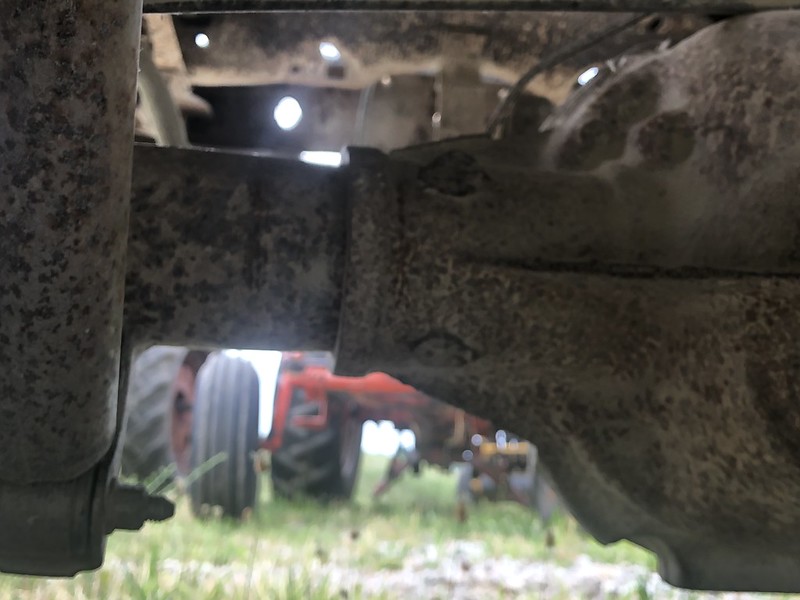

9 years after I cut the factory sway bar brackets off my axle before I swapped it in I am finding myself wanting to add a rear sway bar for my new to me slide in camper.
It is proving easier said than done. Factory Ranger axle mounting won't fit because the axle tubes and center housing are bigger. So I grabbed brackets off of a OBS F-150:
And I end up with this:
So I went and tried the factory Ranger stuff on my pickup box trailer to see if the brackets lock into anything like the F-150 brackets do. I scratched lines where the bracket sits, I don't see anything:
Installed pics from the tech library:
So does it even need to be located to the axle like the F-150 one or is just clamping it good enough? I thought the PS 7.5 bracket locked on to something on the axle but I don't see where it does?
Every RBV rear sway bar I've seen is just clamped. I'd hook up the little pieces to the frame, loosely clamp the axle brackets and move it around so that it's in a happy location, tighten the clamps and call it a day.
In case somebody else comes across this later:
So I cut the locator bits off the clamps to make a king size version of the Ranger hardware:
And I think it is going to work!
I need to enlarge the one radius where the clamp goes over the center section, clean and paint and check that off the list.
Fits perfect!
Didn't do my articulation any favors but it massively improved the trucks road manners.

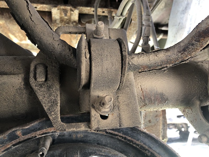

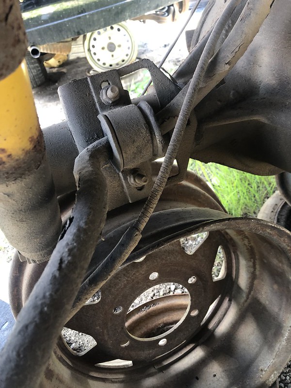

Here is a pic of the same sway bar mounted on the axle before I pulled it. They basically ran this design (bar itself got thinner in '93) from 83-11 and OBS fullsizes ran basically the same idea but scaled up.
When I swapped the Explorer 8.8 disc brake rear into my 99 Ranger l set the threaded clamp blocks on the floor and hit the back side with a hammer. This caused the bolts to splay out a bit and clear the larger axle tube. I ground the tips of the other side so it fit the tube and bolted it together with the original parts.

If I had it to do again I would have left the Explorer sway bar brackets on the axle and just used the Explorer sway bar.
10 years ago when I did the axle swap getting a slide in camper was nowhere close to being on my radar though.
I looked at that and it is better to use the Ranger sway bar because it mounts to the frame completely different than the Explorer one does. I did have to do a bit of grinding on the mount and the center of the rear end had a cast lug that I ground down.
Yeah, I did a fair amount of grinding on the clamp half. I didn't do anything to the axle itself though.
