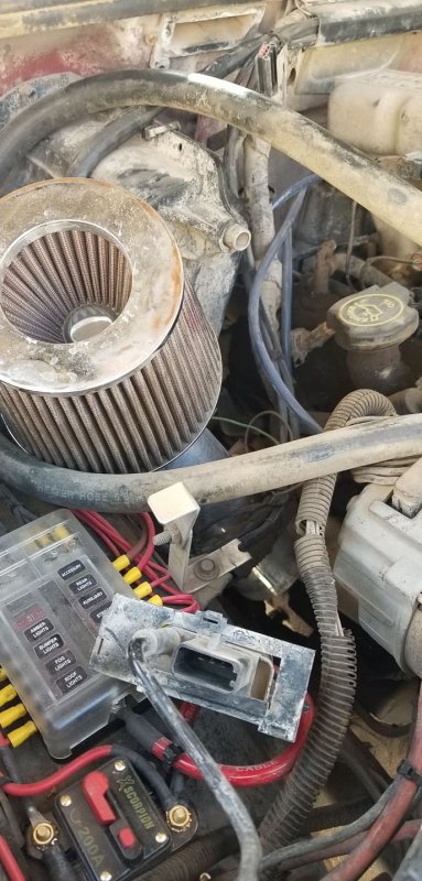

Hi to all from mexico, got some premblem's, my 1989 4wll with 2.9l manual, yesterday the motor star to run high revs, so what I did was to disconnect a vacuum line, the rpm went down but next problem was it star to make off idle, it sound like the motor was stroker, black smoke came off the tailpipe, check the vacuum hoses and the vacuum plug's all good, any what more can I check or clean, so diced it to clean the throttle body but can fine in mexico the gasket, what can I use, this guy from the autozone recommend me a copper spray a gasket? any other options for gasket.
this is what I unplug, only the vacuum line. what it is? thank's for any help.

That looks like the map sensor. Unplugging that will cause exactly the symptoms you describe.

Your air filter isn't attached to anything...
