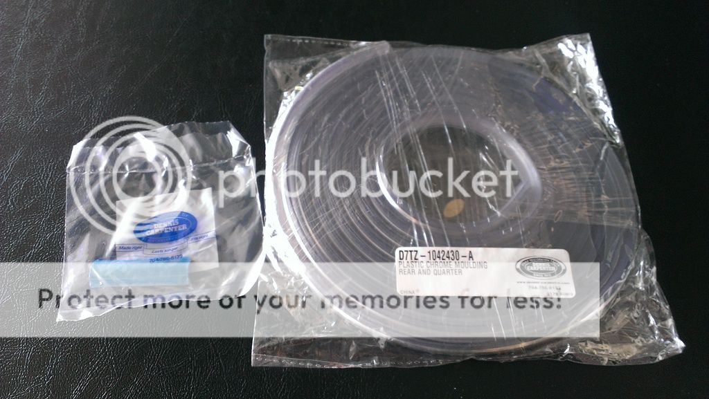

- Chrome trim, Ford part #D7TZ-1042430-A
- Chrome cap (it should come with the trim or you can clean and reuse the one already on the truck}
Trim and cap shown came as a kit from Dennis Carpenter Ford Restoration Parts for $34.95.

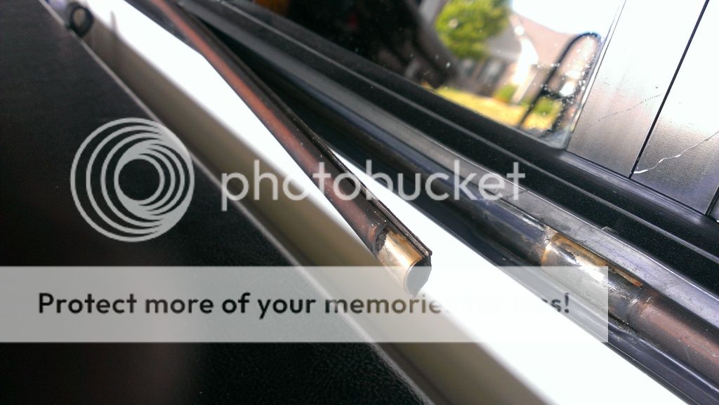

Step 1: Remove the chrome cap with a small flathead screwdriver or similar to expose the ends of the flexible trim. Insert the screwdriver in one end of the cap and pry up gently and slowly as not to damage the seal or pull it away from the cab. If you are replacing the gasket/seal as well, no need to go slow.
Step 2: Once the cap is removed, pry up the end of the flexible chrome strip and again, slowly and gently start pulling it away from the gasket.

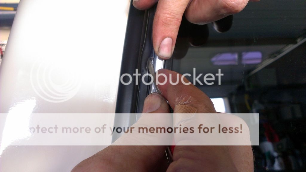

Step 5: With about 6"-12" of one side of the trim seated in the gasket, use the small flathead screwdriver to seat the other side of the trim into the gasket. Go slow and stay patient to prevent damaging the gasket or your fingers/hand. You could also use a lacing tool but the screwdriver worked better for me.

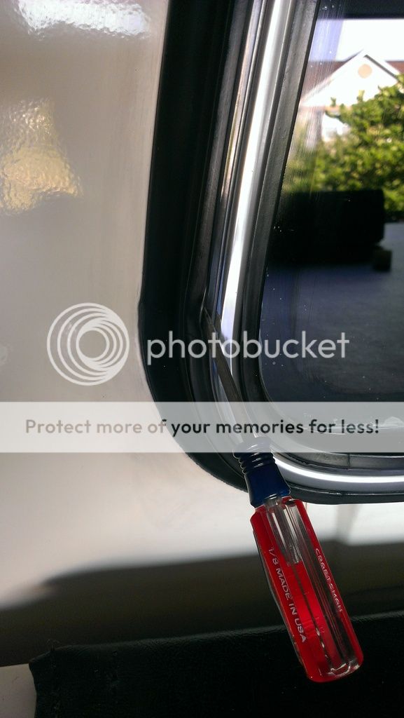

Small, flathead screwdriver inserted into gasket:
Small, flathead screwdriver used to seat trim into place. Use a small amount of pressure with opposite hand as you slide the screwdriver down allowing the trim to seat in the gasket. When seated properly, the trim will lie flat with the gasket over both edges with no wrinkles, bends, or creases.

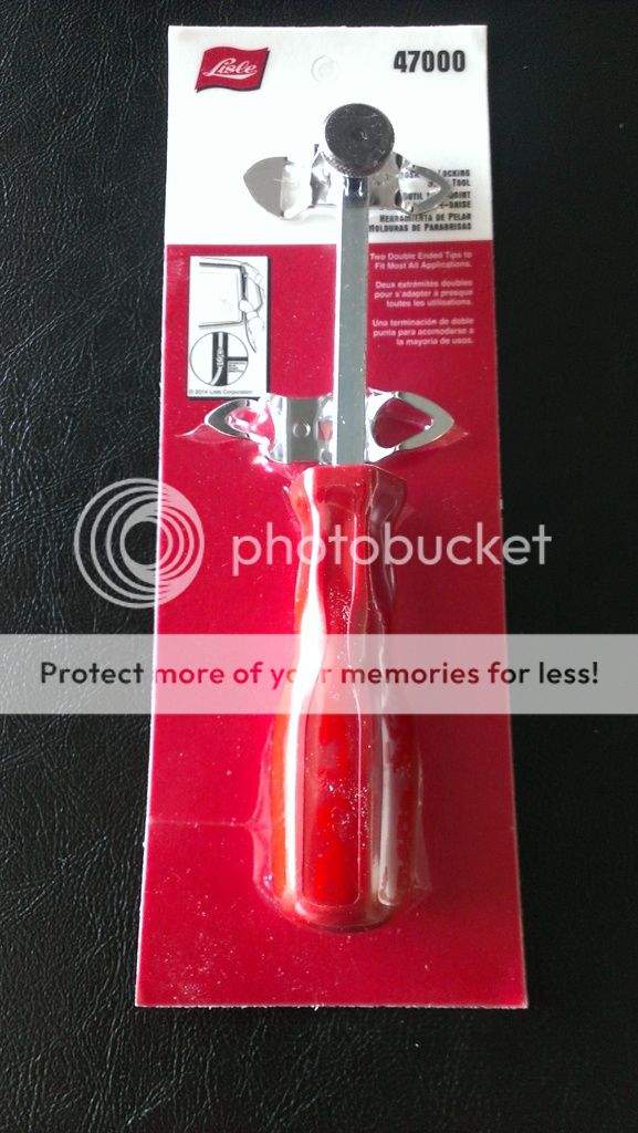

You could also use a lacing tool. The one below cost $12 from Amazon.

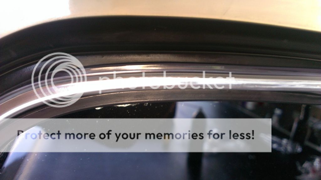

Step 6: Adjust method as needed. As you maneuver around the window you may need to switch the side of the trim you seat into the gasket first...especially in the corners. In the corners I found it easier to seat the inner edge then worked the outer edge about an inch or two at a time. Patience is key. If you use the screwdriver method be careful to pull the blade away from your other hand and body parts because it can come out as you slide it around the gasket.
Corner method seating inner edge first, then outer:

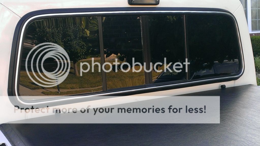

Step 9: Clean glass and any surrounding areas as needed. Admire your work!
Install complete:
