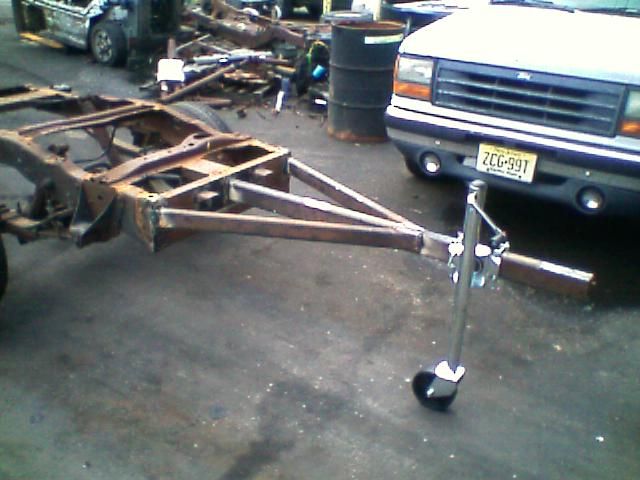

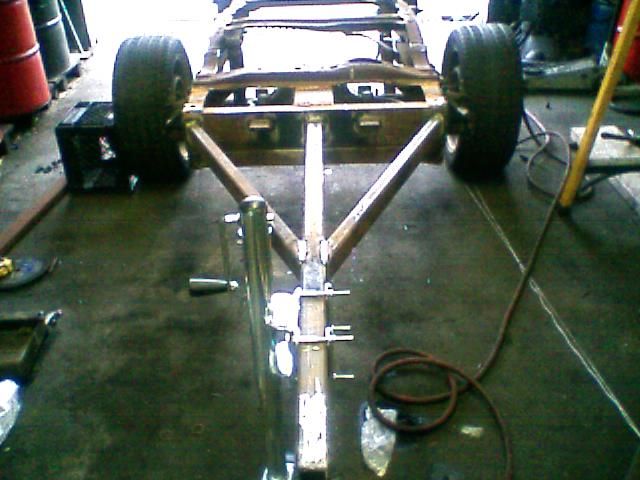

How she sits as of today.
Ranger bed trailer
I have to cut a hole in the front crossmember for the tongue. Its going to extend into the chassis about 8" and be gusseted to the 2nd crossmember. The tongue will extend about 4.5' from the front of the bed and have braces off the frame on either side.

I measured mine and it's 54" from the back of the bed to the front of the tongue.
Thanks, thats what I was planning for this one.

put on a surge-brake coupler to the tounge & you could plumb it to the "old" stock truck brakes! not sure that youd need trailer braks on a ranger bed trailer, but all you really would need is the surge-brake coupler & some hard line. welds look good, hard to beat a stick welder for penetration!
