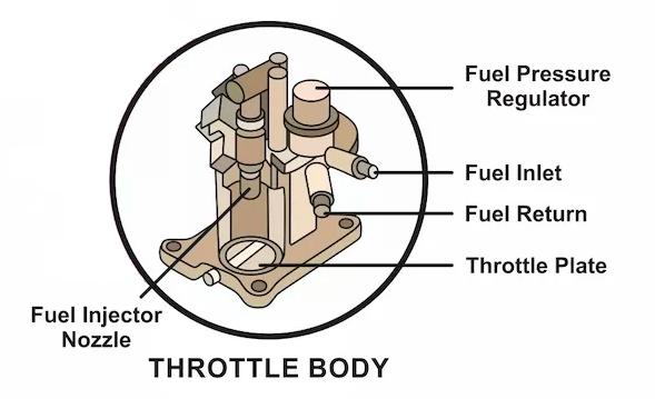

The Chevy 2.8L Throttle Body Injection (TBI)
From 1986-1993 the Chevy S-10 2.8L V6 used a Throttle Body Injection (TBI) that replaced the carburetor used on the 1983-1985 engine. With this setup the 2.8L was now rated at 125 horsepower up from 115 horsepower. TBI, which is basically one step up from a carburetor, uses a pair of throttle body-mounted injectors to spray fuel into the intake manifold. The injectors deliver fuel into the air above the throttle plates. From there, the air-fuel mixture enters the intake manifold, where it is distributed to the engine’s individual cylinders.

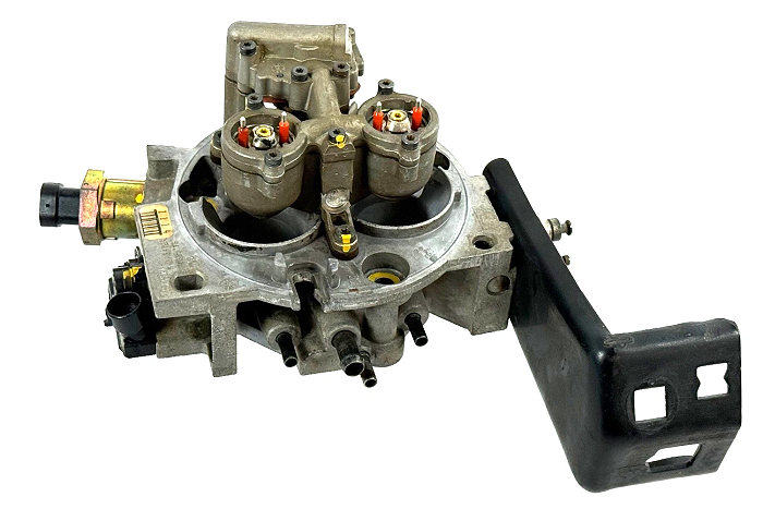

  • Throttle body

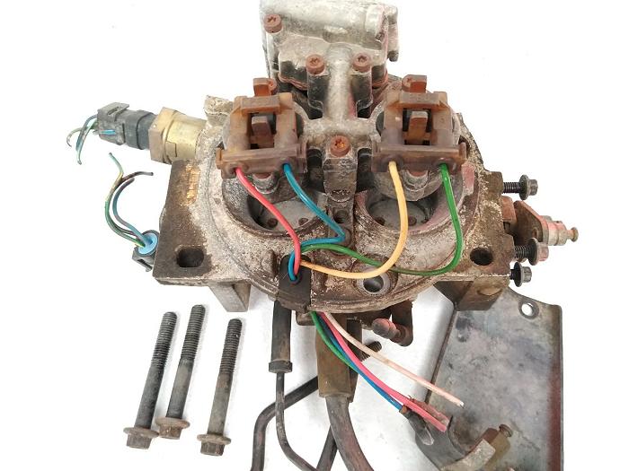

Chevy TBI
