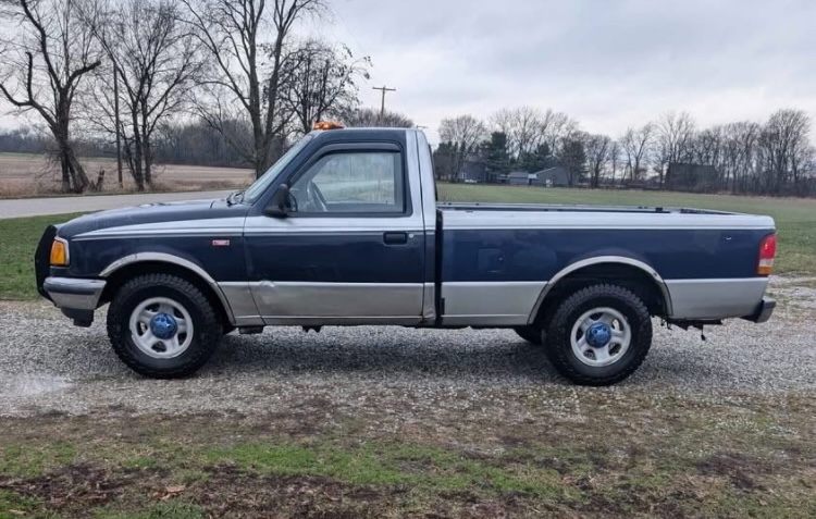

They fit. I had jeep wheels on my ramger for a while. I actually have some tj 15x8 wheels to go on now
I ran 15x7 steel jeep wrangler rims for awhile on my ‘94 . no problems, it originally had 14’s, it also originally had 3.45 gears & I swapped out the whole axle for one with 4.10’s Best tire size for this gear & 2.3 lima is 225/70’s but 235/75’s will work.
