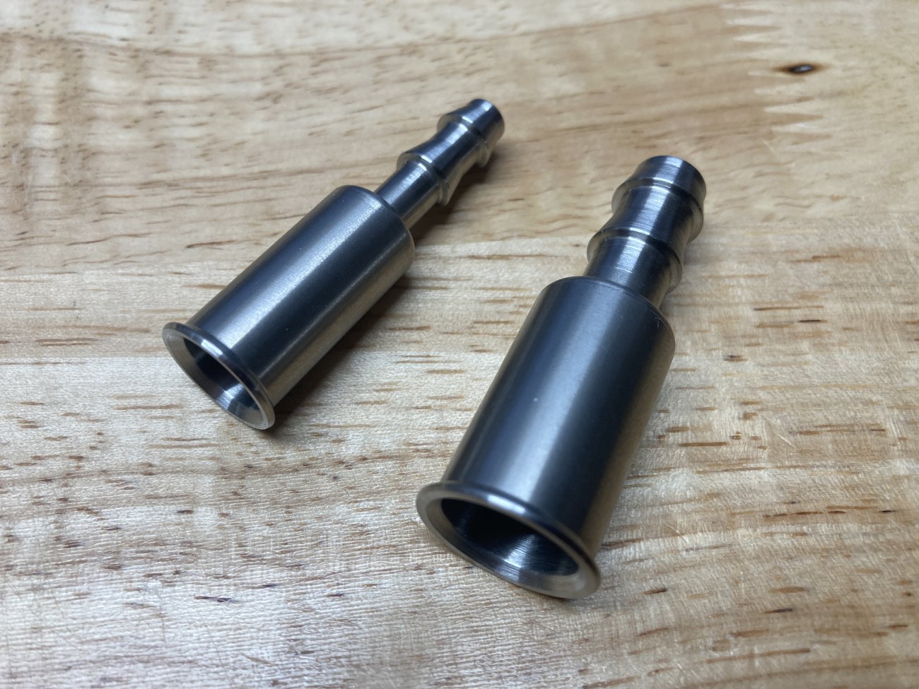

So, both of the quick connect ends are available in -6AN fittings. Male and female in both sizes. I don’t have part numbers handy though.
