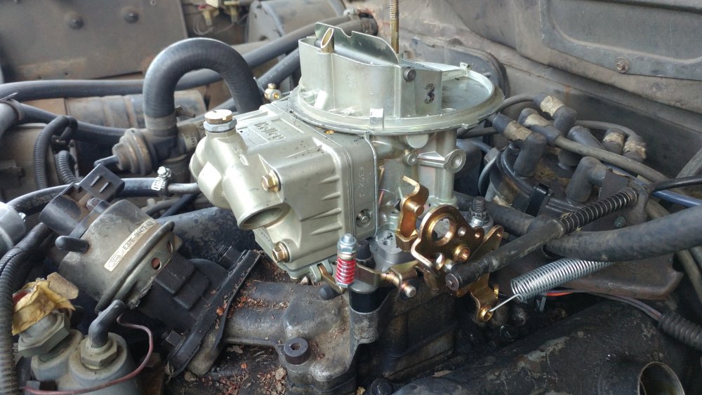

Is the anti diesel solenoid hooked up and functioning on the carb?
That I don't know. I couldn't find a solenoid with that name listed in the Ranger Chilton's, and the replacement Holley is a much simpler carb than the original Motorcraft 2150. Can you tell me where it would normally plug into the carb? I can check once I know what to look for.
On the 2150s its a plunger looking thing mounted to the side of the carb by the throttle linkage.

I checked the carb and no I do not see anything like what you describe. Just in case I'm missing it, I took a picture of the carb on the throttle linkage side.

I should clarify that when we replaced the carburetor, we took out the old Motorcraft 2150 and replaced it with the Holley 0-7448, as recommended in the Duraspark conversion instructions. I didn't provide the carb model number in my previous post.
No its not there.
Id contact holley and see what they reccomend, i think they sell them just for holley carbs.
I apologize; I thought you were concerned that the solenoid, if present, was malfunctioning and causing the stall. Instead, you're suggesting the engine is stalling because that solenoid is missing, correct? If that's the case, I should add that yes we had that solenoid on the original 2150 carb, and we removed it as part of the conversion process in 2015. The old carb ran well after that conversion, right up until late last year, without any stalling problems at all. Also, I don't get a whiff of raw fuel when the stalls occur.

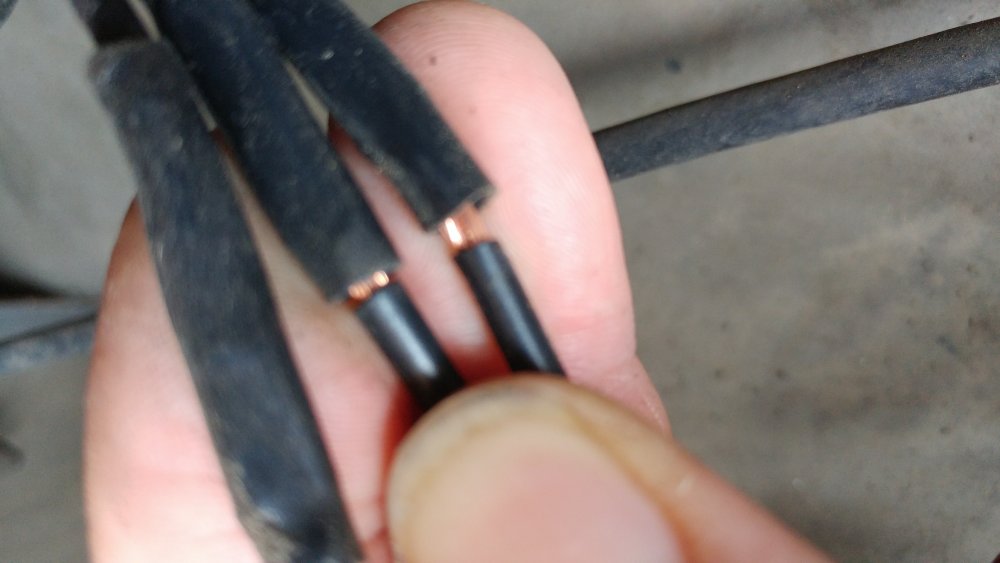

Update: I have found at least one place with exposed wiring. The attached photo shows exposed copper on two adjacent wires coming off the ignition module, going to the distributor. The harness loom hid the exposed wires during previous inspections. When I pushed the loom back, the glint of the copper caught my eye. I spread the wiring apart for the picture; when left alone they lay immediately adjacent to each other. Is that close enough for occasional arcing, and would an arc in that circuit (rather than grounding) cause the truck to stall??
25691
Update: I have found at least one place with exposed wiring. The attached photo shows exposed copper on two adjacent wires coming off the ignition module, going to the distributor. The harness loom hid the exposed wires during previous inspections. When I pushed the loom back, the glint of the copper caught my eye. I spread the wiring apart for the picture; when left alone they lay immediately adjacent to each other. Is that close enough for occasional arcing, and would an arc in that circuit (rather than grounding) cause the truck to stall?? View attachment 25691
If they touch, and are juiced, then yes theyll short and arc.
Since the igniton module/distributor are pretty important id also say yes it could stall the truck.
