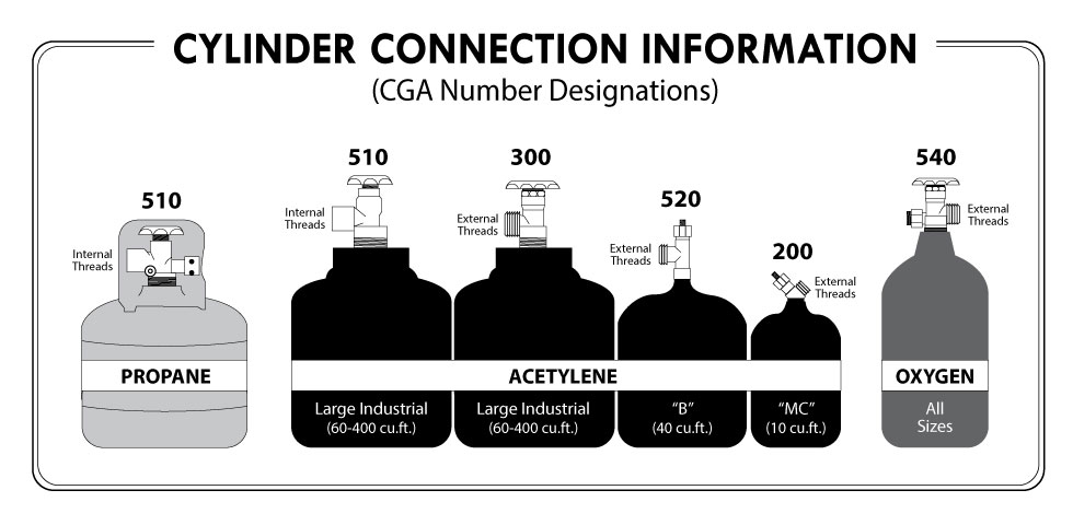

Thanks that chart was exactly what I needed to seeThe numbers are related to the threads for the regulator, have to look at your bottles to see what you need.
Acetylene regulators are not interchangeable with propane, cant remember why. Hoses are different too. even the torch tips are different for LP.
One has left-handed threads so you can't mix them up. I think it's the oxygen.The numbers are related to the threads for the regulator, have to look at your bottles to see what you need.
It's the acetylene that's a head scratcher. I'm gonna figure out the threads and go from there.One has left-handed threads so you can't mix them up. I think it's the oxygen.
It's just so that each gas takes the correct path through the torch and it's controls. Othe fuel gases are that way, too.It's the acetylene that's a head scratcher. I'm gonna figure out the threads and go from there.
