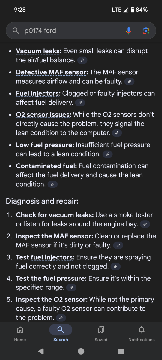

engine-codes.com
  • Dirty or Restricted Air Filter
  • Dirty or Faulty Mass Air Flow (MAF) Sensor
  • Intake Air Leaks
  • Exhaust Gas Leaks
  • Fuel Contamination
  • Faulty or Clogged Fuel Injectors
  • Faulty Front Heated Oxygen Sensor
  • Ignition Misfiring
  • Low Fuel Pressure
  • Positive Crankcase Ventilation (PCV) Hose Leaks
and for those that didn't open the page and read the technician notes (from years of trying to fix this problem):
Tech Notes
The P0174 code means that more air than gasoline is detected in the exhaust gases exiting the combustion chamber. If the P0174 is set in along with the P0171 code, it is highly likely that the problem is caused by an intake leak. If there are no intake leaks, the next step is to replace the air filter and clean the Mass Air Flow (MAF) Sensor. If the problem persists the MAF or Front Heated Oxygen (O2) Sensor will need to be replaced.

So that leaves fuel pressure/injectors/bad fuel or ignition misfire
