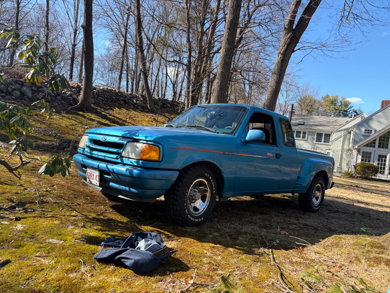

Hi Everyone,
1994 Manual Ford Ranger Splash the 4.0. This is my first post.
For a few reasons, I’m looking to 5.0 swap the Ranger and I’m wondering about compatibility.
I got a lead on a 5.0 from a 2000 mercury mountaineer. I don’t foresee any issues with putting this in the truck, however my concerns arise with what transmission to use. Can I buy a T45 out of a V8 car and use that? Will the T45 even work with my truck? Will I need to buy a T5 and adapt that to the 5.0 block?
I have a 7.3” rear axle? Got a lead on a good 8.8” that I’m open to picking up. Are there other options out there that would make this easier? Could I just buy a whole explorer drivetrain?
Really just looking for knowledge and options from people that have been doing this longer than me.
