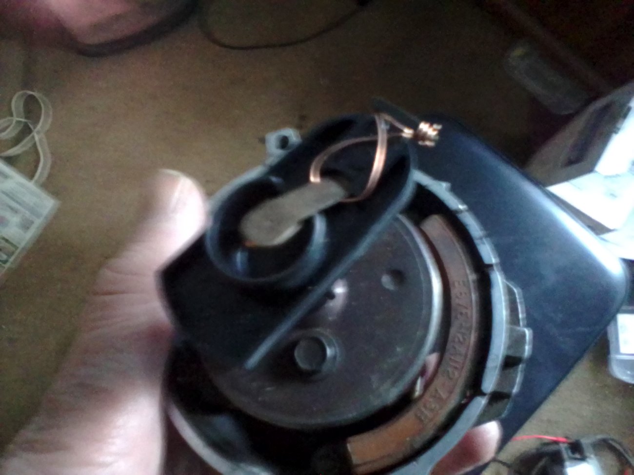

I'll admit to being old enough that I've worked on point type distributors which were easy to set using static timing. With the ignition on and the engine preset at whatever the timing was supposed to be, you rotated the distributor until the points opened and your test light went off, and that was where you'd get spark at the #1 cylinder.
I'm wondering if anyone knows of a way to set the distributor on a 2.9 using a similar method. Seems like there should be a way to do it using the SPOUT terminal and monitoring for voltage or resistance change with a DMM, but I haven't found anything like that described anywhere. I'm replacing the distributor on my '87 (Ranger) and I set the rotor pointing to the #1 cylinder with the engine at 10* BTDC using the crankshaft marks. Just to be sure, I wrapped some thin wire around the rotor, put the distributor cap back on, and then rotated the cap and distributor bowl counterclockwise, opposite the direction of rotor travel, until a DMM connected to the coil wire terminal and #1 cylinder tower went from infinity to 0 ohms. I figure that should give me the leading edge of the rotor travel as it approaches the #1 cylinder.
I'm thinking there's probably a better way but that's the best I could come up with. I've been going around and around with this thing and when I get it back together I'd like for it to start and not need a lot of adjustment. Appreciate any suggestions or feedback.

The best you can do is to get it close by eye, then unplug the SPOUT wire and set it with a timing light. I don't believe there's a way to set it like a points engine.
You already spent more time on it then I would have.
Just drop it in... eyeball it... pull the SPOUT... have the timing light connected... snug up the hold down bolt so the distributor doesn't move unless YOU move it... fire it up.
A timing light with advance is nice but not necessary.
Ill add...
I cut my teeth with points... I never statically timed those. Likely because my mentor never did...
Thanks, we'll see how it goes. My timing light does have advance, so I'm guessing that it can be set to 10* and then use the TDC mark to set the timing, probably easier than using the degree scale.
@j-driver
The engine should be at normal operational temperature when you pull the SPOUT jumper. Factory base timing is 10°BTDC, 12° can be a good thing.
I use the vacuum gage and advance the timing until the needle stops rising and begins to flutter, then shut it down/lock it down; it is how I was taught to time the Bowtie 350, my mechanical mentor said try it on the 2.9l and see what happens...it worked so well it is my go-to with the 2.9ls...)
