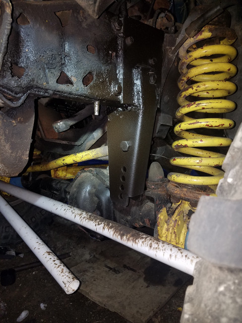

Got the rear end all bolted up with 6400 shackles and got the front end sitting on the ground with radius arms bolted up and coils sitting in the buckets..
Mocking up the tracks bar mount tomorrow and then measuring steering linkage to get from partsmike.com

Today I mocked up a track bar
And installed my custom bumper

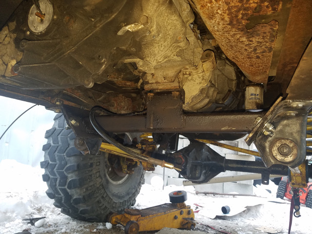

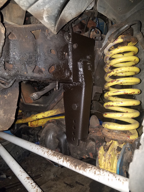

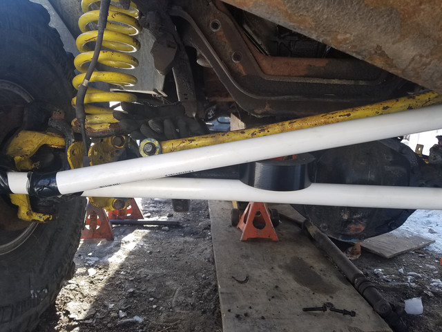

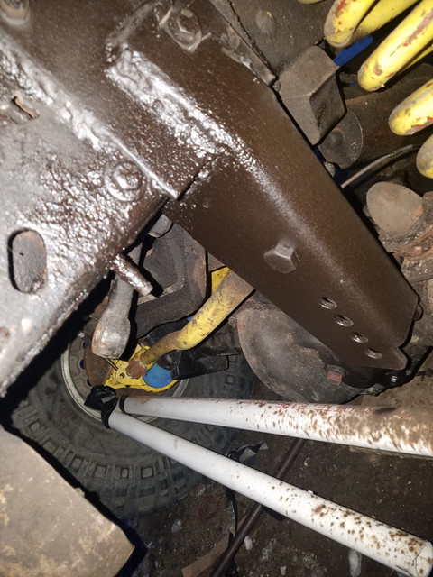

Got my track bar mount finish, also got my transmission crossmember finished and installed, and used dell from partsmike.com idea to get measurements for my steering linkage mocked up
free website upload
Track bar mount looks like shit! :thefinger: Shouldn't have taken advice from some asshole on Facebook!
Nah truck looks good, didn't know you had a build on here :icon_thumby:
Oh yeah, see you're running stock buckets. I did too for a bit. You figure a way to hold the coil in the bucket yet? I had thrown a couple hose clamps around each spring and bucket to hold them in just in case. Don't forget to paint them though or else everyone will give you shit.
Haha I didn't know that asshole from Facebook had an account here. But yeah I ordered the coil retainers from bronco graveyard I'm just gunna drill a hole and clamp them in with that. Steering linkage got ordered up, found out I needed a new pitman arm and a reamer for my knuckles so that being said the steering linkage was a whopping $450 so hopefully it works haha but del from partsmike is a good guy and knows his stuff
