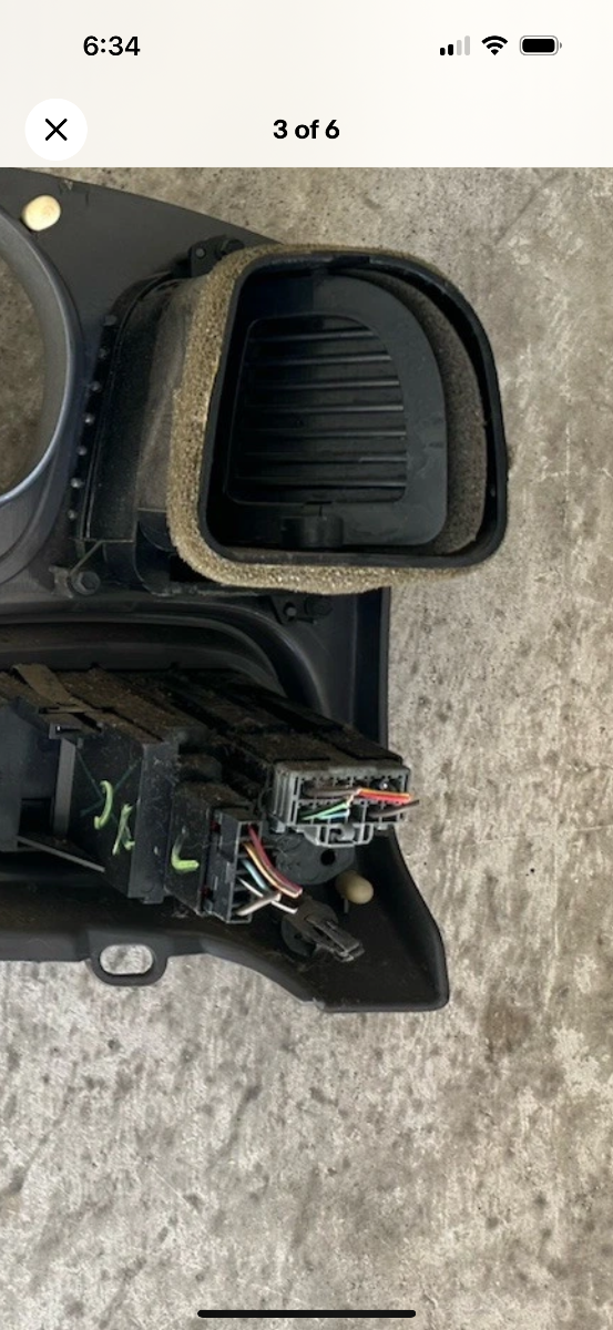

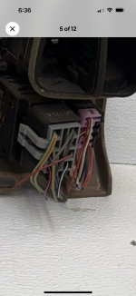

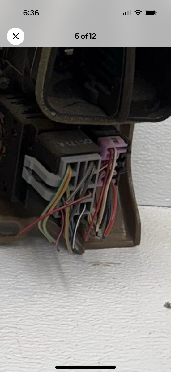

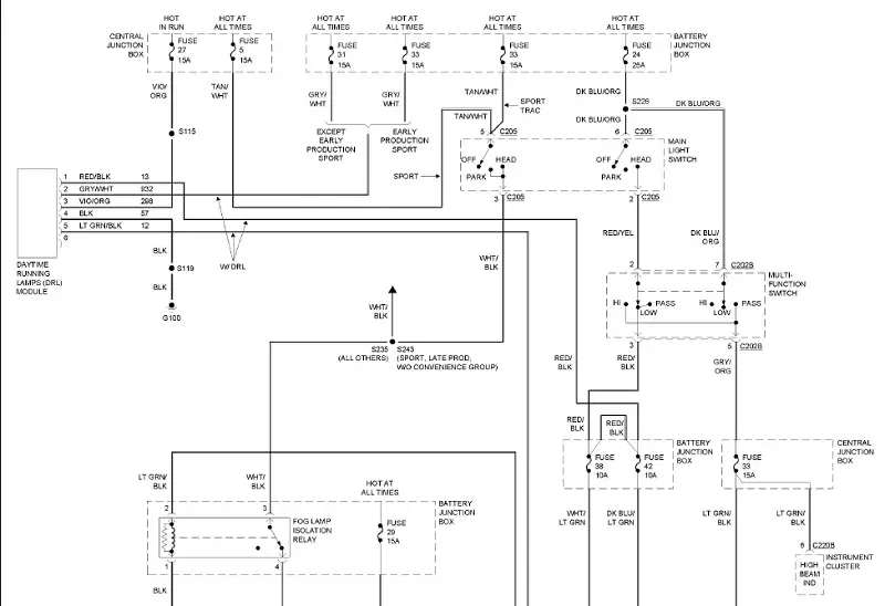

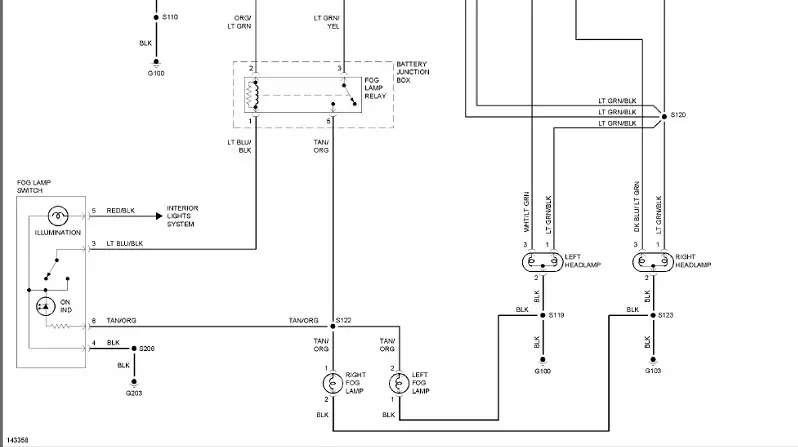

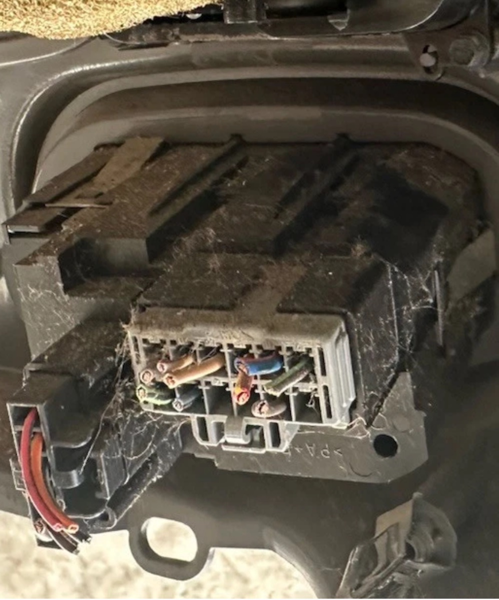

I couldnt find much so here we go asking :-). The other day on a ranger forum, someone posted this, its sick and i want to swap it over. From what the post said, the connector was different. Integrated on the headlight switch is the fog light switch, that used to be by the radio. Am i crazy to think that ford might have even used the same color code and you can probably repin the connector. Has anyone done this swap, is it even possible? With all the interchangeability between a lot of the parts. Its crazy to think that ford would retool a harness, thats not cost effective. From the factory, you have a few different harnesses avail. You could take any 03 std cab ranger barebones and the only thing different is more wires for the additional options. Appreciate the help. I found what i think is the correct harness. My buddy at ford is gonna print me up the pin out.
