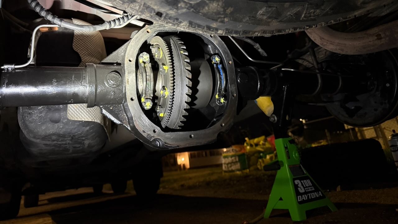

First of all if your truck has an 8.8, in good shape and you aren't looking to change the gear ratio, simply find a quality 28 spline LS/Locker carrier and put it in. By quality I mean Ford, Eaton, perhaps Auburn. Particularly for Ford ones Ebay is covered up with them, you can get the clutch packs easily from FRPP and you're in business. If you use Ford carrier bearings, use quality parts and no one has previously monkeyed with it, it is highly unlikely that you will need to do anything but put back the factory shims.
  1. Note: if you are reusing gears disregard everything you see on the tube of you and read about gear patterns, your goal is not to get the perfect gear pattern, a pretty good one or even an acceptable one, it is to get exactly the same pattern it had to start with.
    1. With this in mind if you are only replacing the carrier you will need to buy, beg, or borrow a magnetic dial indicator and some gear marking compound.
    2. If you're replacing pinion bearings, you'll need a way to measure the pinion depth, a beam style inlb torque wrench and a set of dial calipers. Again it's unlikely you will have to change any of this but it needs to be checked. If you're going that far, I recommend a crush sleeve eliminator.

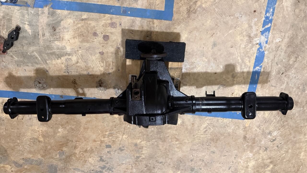

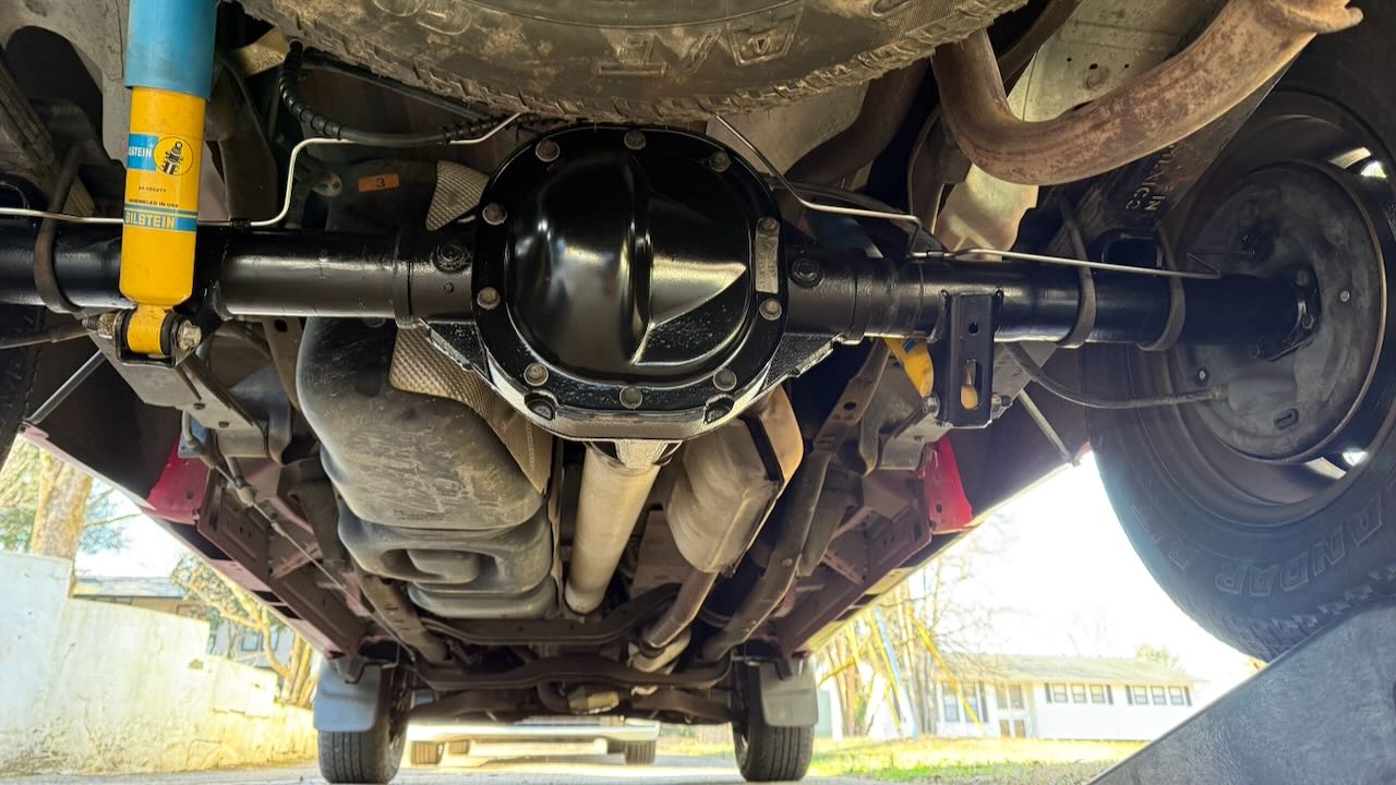

So here's what i ended up with, I bought a decent housing 4.10 ratio open with 160,000 miles on it. I did find a 4.10 LS (R7) but it was very rusty, to the point that the rear cover which had already been replaced once was about to rust trough again, it had wheel spacers on it and the axles and bearings were shot, the clutches were worn out. The second one was only slightly better. the third one was a nice housing and fairly clean, though they had decided to paint it poorly so I ended up stripping it and painting it. I esuntually got a good housing and a good set of gears. The axles weren't any good and one of my original 7.5 axles wasn't any good without an axle saver (the axles shafts themselves are interchangeable) so I had a choice, i could get a 31 spline Traction-Lok (or any other carrier) and have a set of custom axles made by someone like Moser with 31 splines but 28 spline axle bearing races or i could get "stock axles" and a 28 spline carrier. I was able to find a new but discontinued 28 spline Detroit Truetrac and a set of factory Ford axles for about what the custom axles and a FRPP Traction-Lok would cost. (there were multiple choices for these including Auburns, Detroit Lockers and Detroit Truetracs.)
I put this all together with new bearings from FRPP, new lines from Inline tube and a new hose from Motorcraft. As I mentioned above I checked it all when I took it apart, I put it all back together with the new bearings, the Detroit Truetrac and the factory shims, unsurprisingly everything was exactly the same except for backlash which was ,001 tighter. Perfect.
