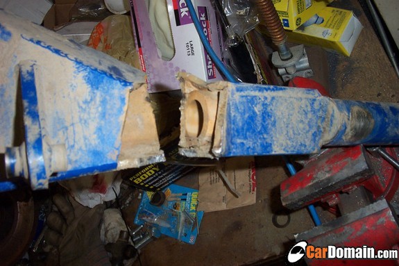

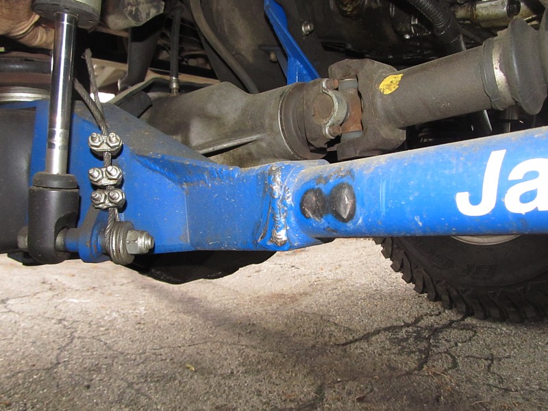

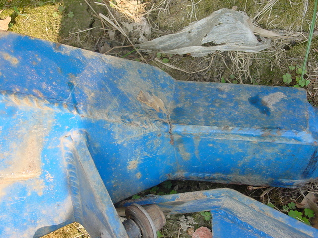

I ran my Skyjacker lift fairly hard in the rocks and bent one of the radius arms and the transmission crossmember. Tubing was pretty thin, was 1/8" wall at most. Would be better if they used thicker wall tube... but to be fair it's not advertised as rock crawling parts.
