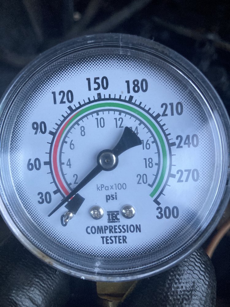

I just did a compression test. Bad news, all cylinders but #2 have around 125psi. #2 has less than 20.

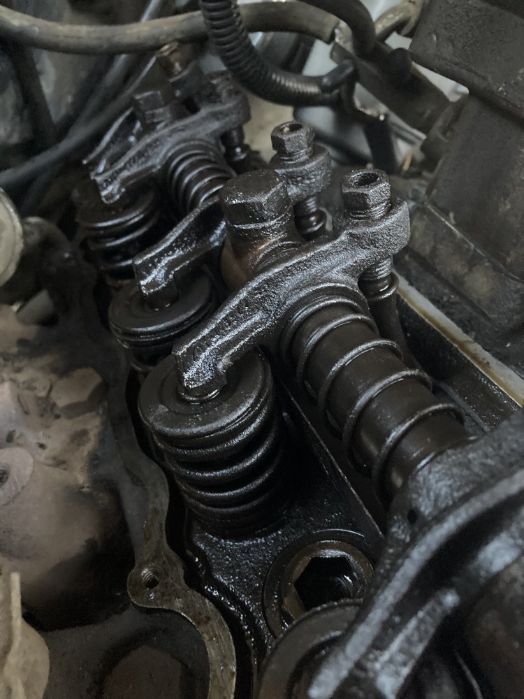

I pulled the valve covers off and can’t see any visible issues with that particular cylinder. Springs are intact and when I spin the motor things look to function as they should with the exception of their not being much oil up in this area. Photos attached.
Failed ring or a piston with a hole in it?

Time for a leakdown test to tell you if you have a valve issue or a piston issue.
Leak down test on cylinder 2 at TDC for that cylinder there is air coming out the tail pipe; none out of the PCV valve or carburetor and no bubbles in the coolant. I guess I have my answer! Time to pull and rebuild the valves. Anyone ever done this job themselves (the rebuild)? Or would it be better to send the heads off to a shop?Might as well drill the coolant holes down there while I’m at it I guess…
I’d pull the head and see what you’re dealing with. You may be able to get away with lapping in a new exhaust valve or just cleaning up one that’s stuck.
I wouldn’t modify the head by drilling additional coolant holes, they do pretty well without it.
