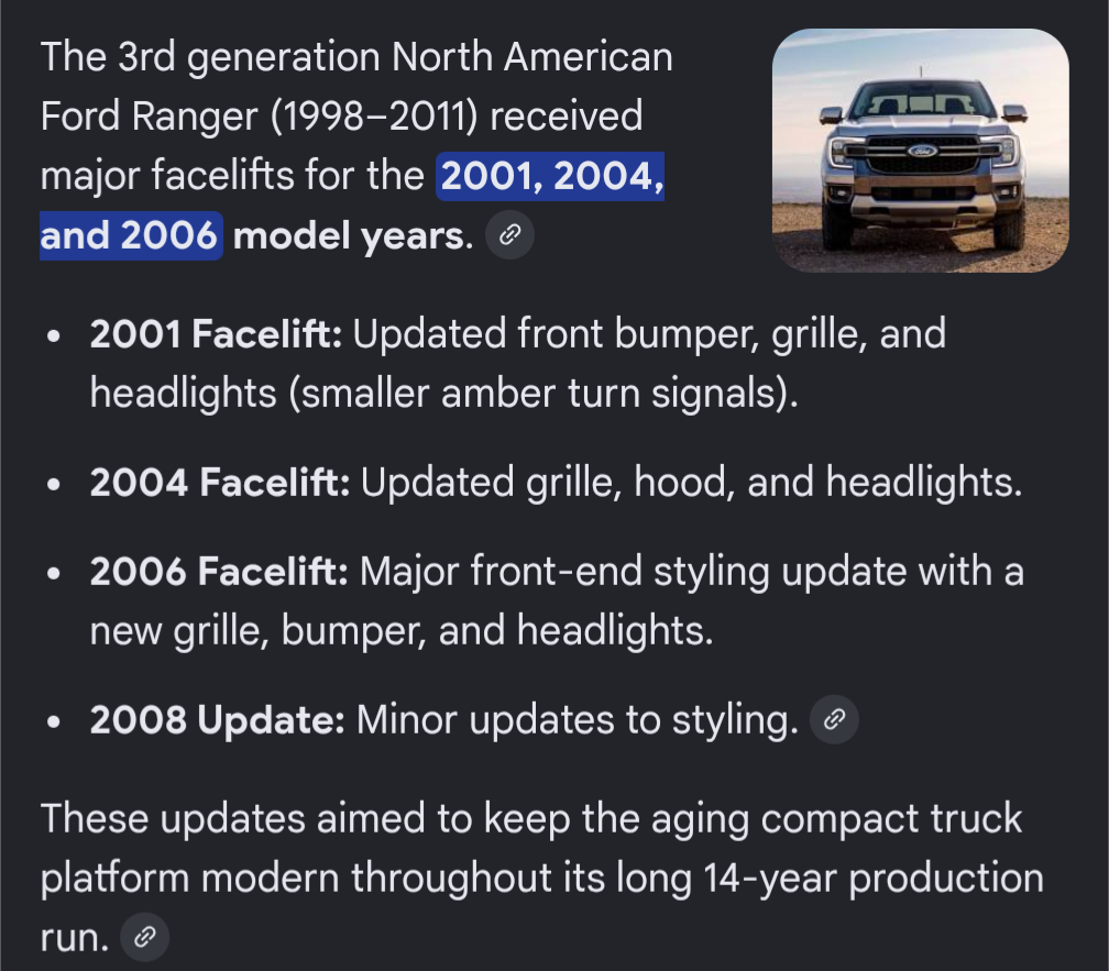

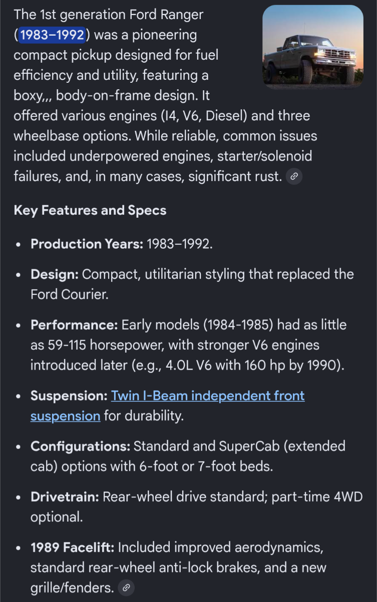

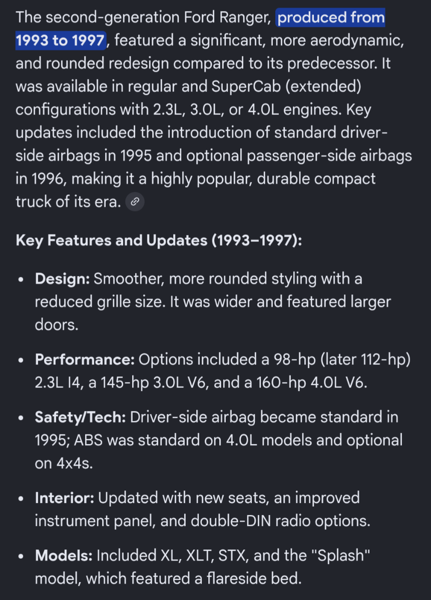

1997 is a second Gen. It's the last year of the second Gen rangers. First gen is from 83 to 92, with the facelift for first gen being done in 89. Second gen is from 93 to 97 with the facelift being given for 2nd gen in 95. 3rd gens are from 98 to 2011, with multiple facelifts being done for that generation In 01, 04, 06 & 08. Each generation of ranger model has had at least one facelift during the duration of that generations production. You seem to be confusing certain year facelifts with actual generations, the 89 model changes were a facelift, not a new generation. First gen had its facelift in 89, second gen got its facelift in 95, and third Gen had multiple facelifts. First gen is 83-92, second gen is 93-97, third Gen is 98-2011. You can Google all of this for further clarification, and you can also check What Ford Motor Co says about this as well. I get that your basing your assumption off of someone's post and what they think the generations are or should be, but Ford is very clear about what years constitute what generation, and wether they are Pre, or post facelift models. Going off of what the post you're sharing is saying, 83 to 88 is its own generation and the facelift in 89 means that 89 to 92 is a seperate generation. But then in that same post it says a "3rd gen" is from 93-97. However, that year range (generation) also had a facelift in 95 (which is what happened in 89 that you're saying is what makes 89-92 a different generation) yet you don't split 93-95 and 96-97 into two seperate generations? That makes no sense whatsoever. So some facelifts constitute a whole new generation and some don't? No. Not how it works. And going off of that posts assumption then that one facelift year creates a new generation, that would mean then that all facelift years create a new generation, meaning that 83-88 is gen one. 89-92 is gen 2. 93-94 is gen 3. 95-97 is gen 4. 98 to 01 is gen 5. 02 to 04 is gen 6. 05 to 06 is gen 7, and 07 to 11 is gen 8. Do you see how this doesn't make sense? You can't just say one facelift, that Ford motor co even says is just a facelift for that generation, is a new generation, and then say that another facelift in different years doesn't make a new generation. The facelift years do not constitute a new generation, a facelift has been given at least once to each generation. Ford is very clear about that. I get that the post someone put up says what it says, and everyone is allowed to define or identify anything however they want to in this day and age, but that's not how Ford Motor Co. defines them. Again, you can Google all of this yourself if you don't believe me. Hope this has helped you to understand this better.

Ford doesn't care about "generations" they changed things around in between what anyone calls generations.
The post I linked is put together by input from Ranger enthusiasts who live by working on these trucks, actually the owner of this website (@Jim Oaks) is the one that made it.
89 "Facelift" was major. Front clip obviously is different. Inner cab structure is changed to support the new dash making a dash swap rather difficult. Rear wheel arches are bigger. Wiring is totally different. fuel systems are different, Powertrains were changed. Very little directly interchanges between them.
Really a 89 has more in common with a 93 than it does an '88. Electrical systems are more similar, powertrains are have more in common and the dash (93-94) is the same while all the sheetmetal is still different.
I don't care what you want to call it, as someone who hunts down' parts for a first gen (83-88) a second gen (89-92) is nearly worthless to me for a direct replacement part. Pretty much everything is different. When everything is different... to me it is more than a facelift.
