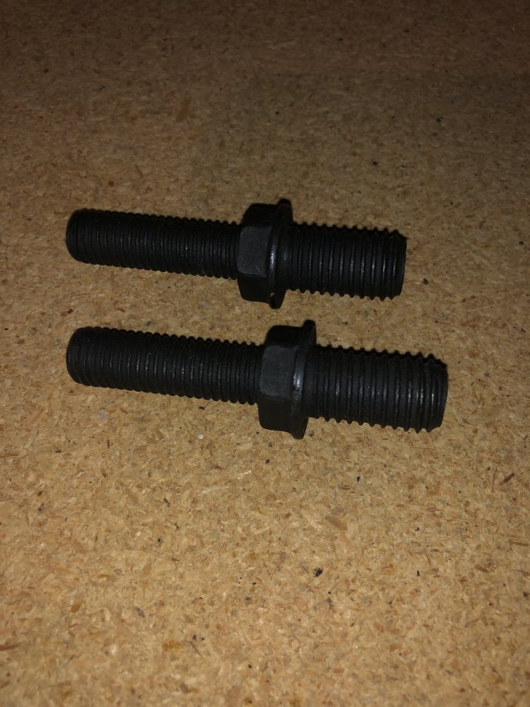

This is what they looked like when new, good luck.
M10x1.5 was the closest match I had, but it wouldn’t chase these cleanly.
