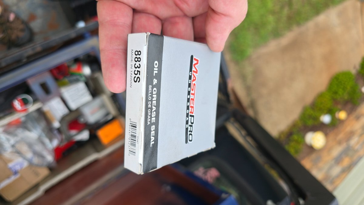

Any idea what size seal I need? The parts stores Oreilley, Autozone, Advance don't have the FX4 option when you specify your vehicle.
If the Torsen really is a 31 spline, I'd look for the largest seal offered or ask for one for a 91-01 Explorer...
It's for a Ford 8.8", 31-spline axle. I know OReily's has them. I had to buy one in New Mexico and replace one at a campground in Colorado just over a month ago.
