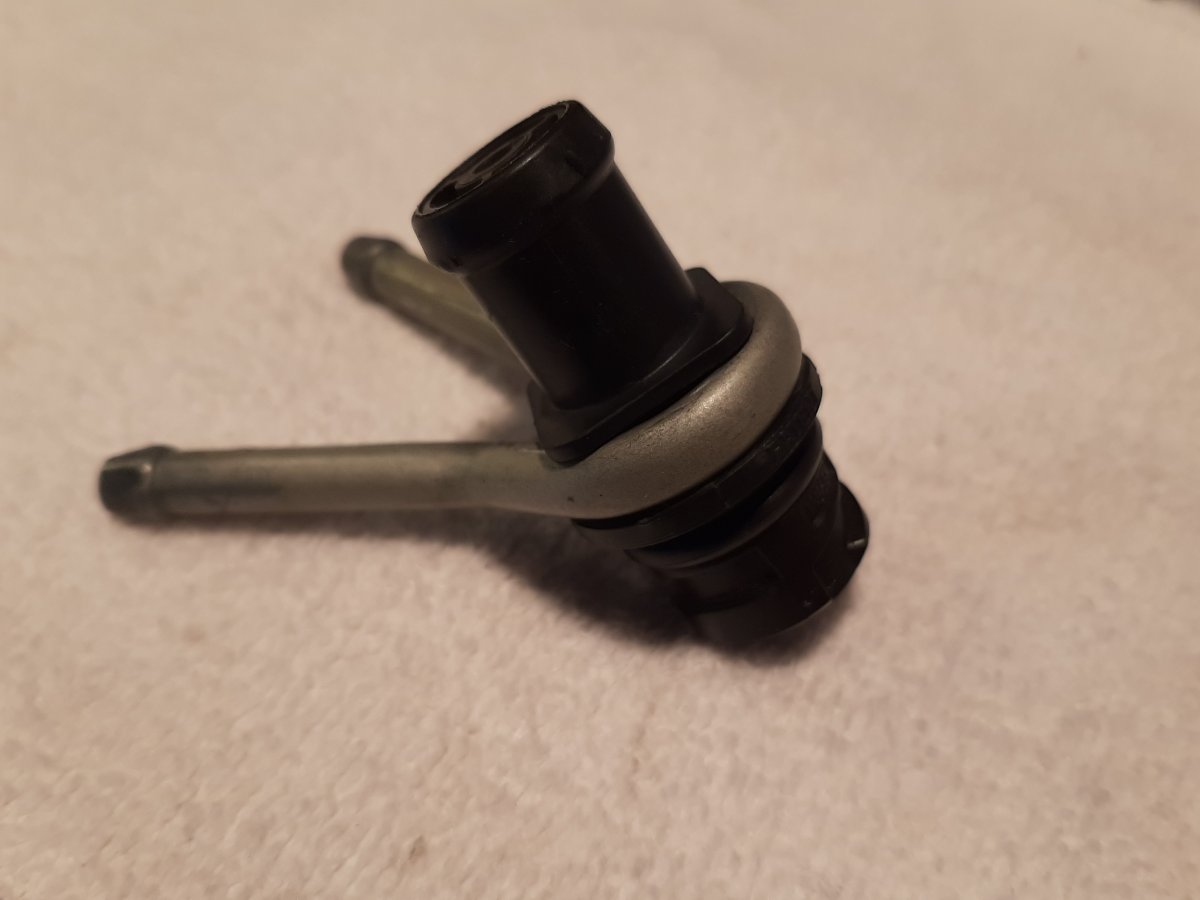

I am planning to replace my PCV valve. My 4.0 SOHC has the heated PCV valve. The Motorcraft EV268 is the direct replacement but I plan to reuse the existing tubing that wraps around the PCV valve so I don't have to partially drain the coolant. That means I would just throw away the new tubing that comes with the new PCV valve. I have found another part number that looks like the same thing without the tubing to heat it. It is Motorcraft EV243. It looks like it has the same groove in it that the tube fits around. Yes, it is only a few bucks less than the one that comes with the tube, but I don't like spending money on something I am just going to throw away.
So the question is, does anyone know if the Motorcraft EV243 will fit my 4.0 SOHC valve cover and allow the tube to fit around it? All the websites I look at state it does not fit my vehicle, but I think that is because it does not have the heater tube. Is there another Motorcraft part number that comes without the tube and will work for me?
Yes, Motorcraft EV243 fits 4.0l SOHC valve cover and you can install the hot water tube on it
Be careful with these "twist lock" PCV Valves, the Valve cover part gets brittle and can break, so easy does it
Have to replace valve cover if it breaks or get creative
Ford#ev243 wOut 5/16"CoolantOxbow & Ford#ev268 With 5/16"CoolantOxbow,
are both the very same PCVValve wOut\With that useless CoolantOxbow;
both fit the 1/4Turn hole in the rear of the left ValveCover on the V6~4.0l~SOHC.
Yep, be gentle removing\installing the PCVValve as the plastic tabs in the ValveCover break easiliy.
Recommend deleting the Oxbow & the associated 5/16" Coolant Hoses+Tees;
this warming loop is a "Rube Goldberg" design that really does not work & is only a potential source of coolant leaks.
Especially considering your warm climate, UNLESS California inspections require it to stay in place?
If you keep the PCVCoolantLoop, recommend replacing leaky 5/8~5/16~5/8" plastic Tee with a Stainless barbed Tee (Amazon\Ebay) & stock hoses.

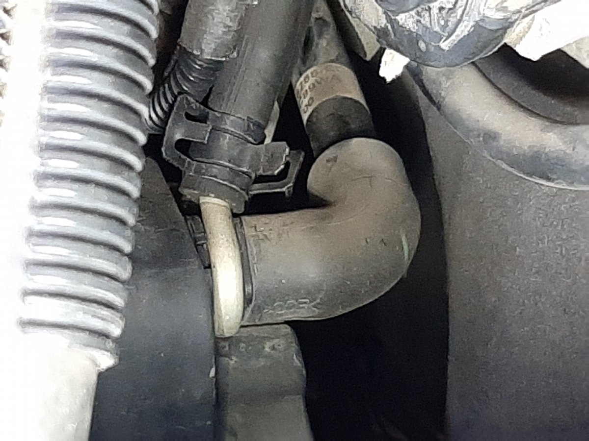

I was having a difficult time figuring out where the 5/8~5/16~5/8 plastic Tee is. I followed the coolant line that connects to the metal loop for the PCV valve and I think I found the Tee. It appears to be on the right front side of the intake. Mine has not been leaky for the 264K miles I have put on it, but is probably due for a replacement. Thanks for letting me know about it. I replaced the rubber elbow that connects to it with a silicone one many years ago.
Actually the 5/8~5/16~5/8" plastic Tee I was refering to is near the FireWall
were the PCV Coolant Loop joins up with the Heater Coolant Loop;
it's a factory prefab molded Tee+Hose assembly that notoriously cracks+leaks & is an expensive Ford OEM part.
Can be easily replaced with a 5/8~5/16~5/8" barbed Stainless Tee, just have to order that online ahead of time,
& stock 5/8" + 5/16" Heater Hoses.

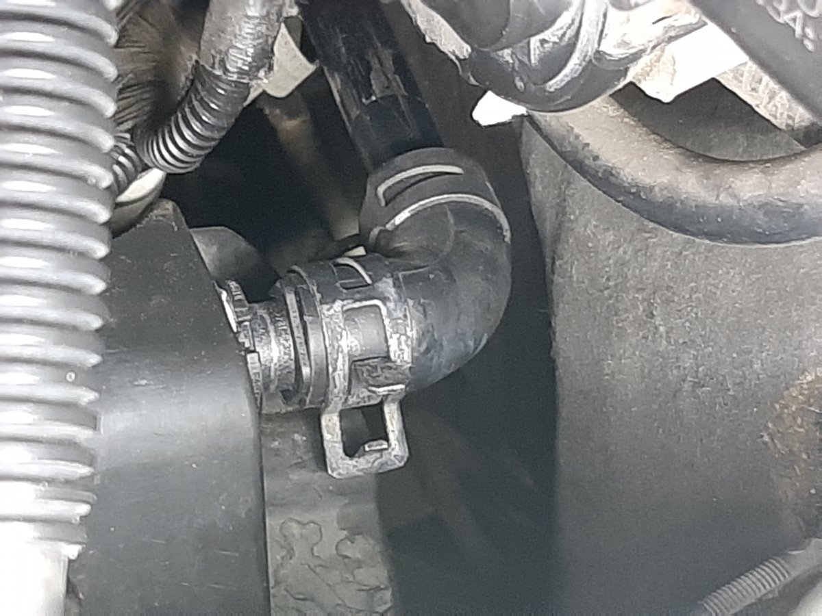

Think you're referring to the 5/8" Vacuum PCV Elbow on the right side of the IntakeManifold (on that PitchForkShaped PCVHeatExchanger)
that also notoriously cracks+leaks & generates P0171+P0174 TroubleCodes;
it can be replaced with a stock 5/8" HeaterHoseElbow that will last much longer than cheaper\thinner VacHose.

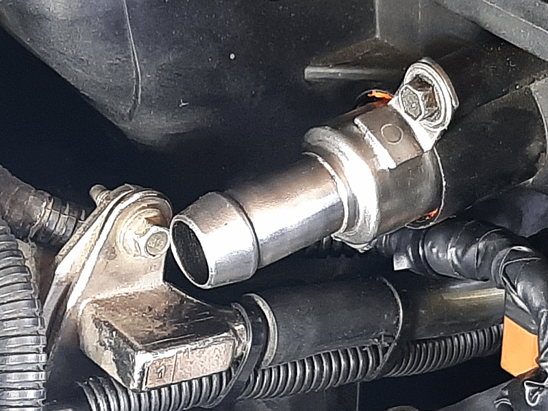

Okay, I think I have found the 5/8~5/16~5/8 Tee. Once you said it was on the heater hose, I just followed it. It looks like it is only replaceable with a complete hose assembly other than ordering the stainless steel Tee you referred to. I think I will order a SS Tee and keep it in the cab in case my original one fails at a inconvenient time.

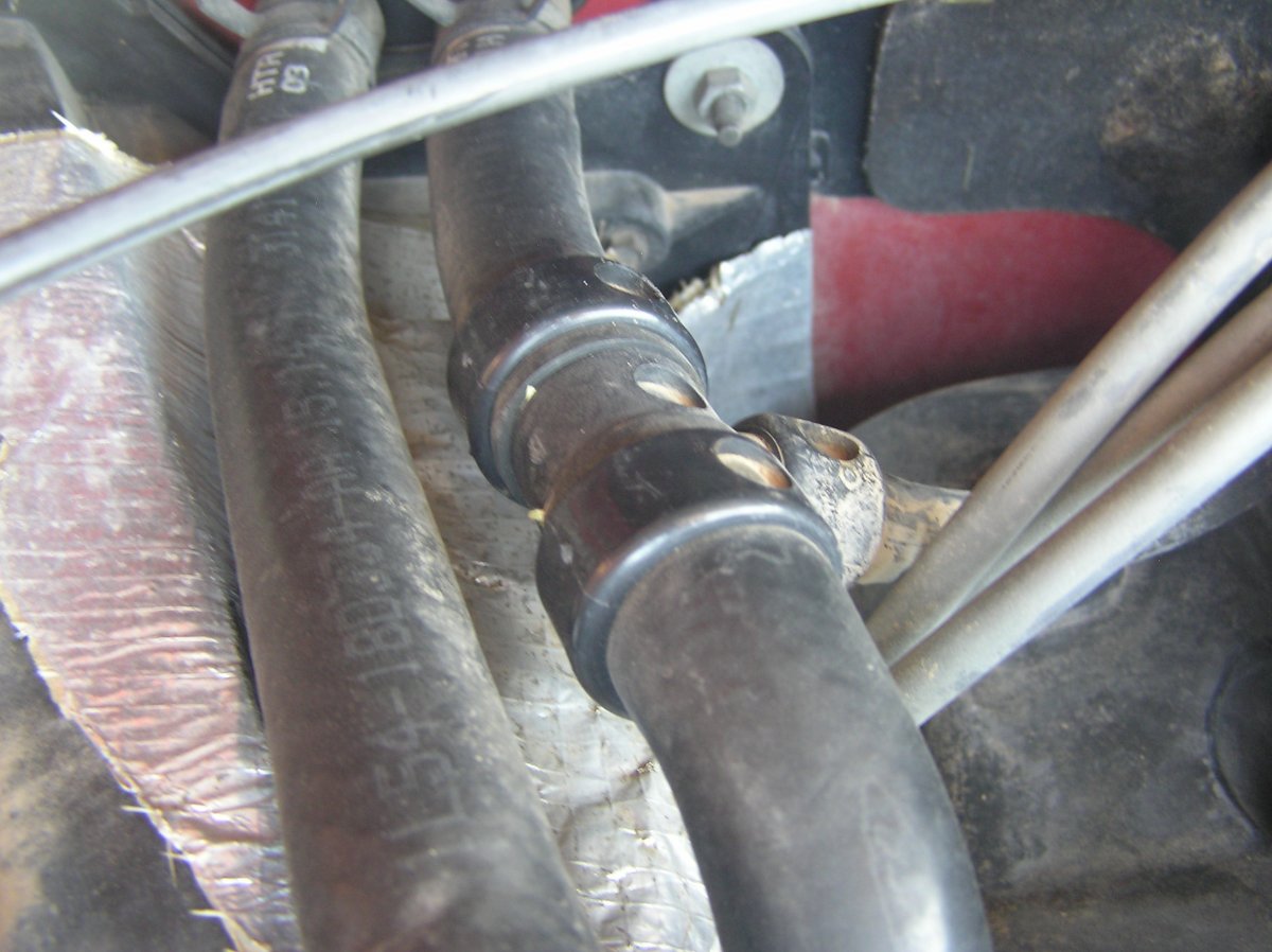

I can see why it is expensive to replace, since it probably only comes with a complete hose assembly. Here is a photo of it so you can confirm it is the right one or not.
64833
Yes, stock replacement requires all the hoses as one piece
However you can replace just the "T" or eliminate it with off the shelf "T" or coupler and hose clamps
There nothing different about the hoses, just regular heater hoses
