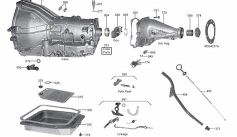

I googled "5r55e exploded view with part number" and got this:
you are looking for part number 371 on that right... might try googling similar and see if you can get real part numbers. (the site that pic came from was useless)

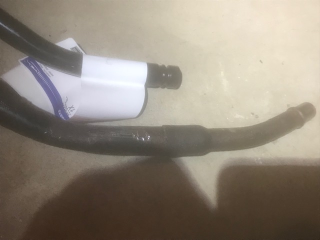

Thanks for the fast response, and taking the time to dig around the net. That part, #371, isn't the piece I was looking for, but I may need it also. Here's a couple pics to show what I'm looking for.
New tube on top, old 2 piece tube on bottom.
Close up of the tubes. You can see the short extension stuck on the end.

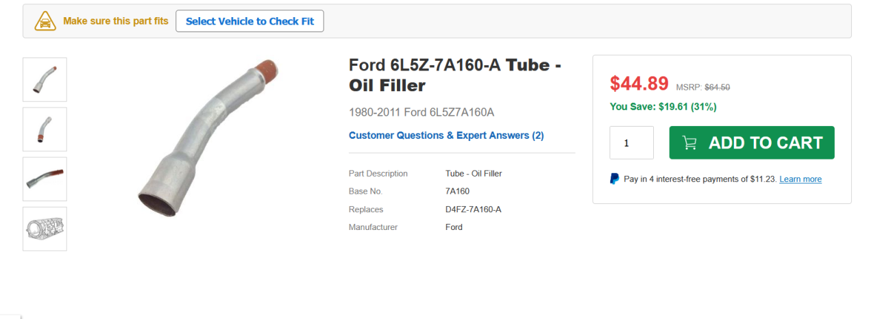

Found it! I went back to the online parts catalogs again and noticed a part I had overlooked before because the pic didn't resemble the part I was looking for. This time I noticed the description 'Tube - Oil Filler'
I then saw it was replaced with part # 6L5Z-7A160-A so I looked up that number and found this:
So far, so good. I got under the truck this morning got a good look at where it goes into the transmission and it doesn't look like any other parts will be needed.
