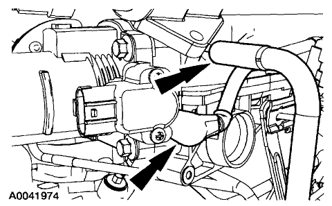

It was not an electrical connector. It is the vacuum connector right behind the throttle body, on the drivers side. There are 3 vacuum hoses that go into the slip on connector.
It is the bottom arrow in this pic.
What ron is saying is, you probably knocked an electrical connection loose at the same time you knocked the vacuum line loose. There's no correlation between that vacuum connection and anything that would cause an electrical issue so look around where you were fiddling to see if there's a broken or loose connector somewhere.
