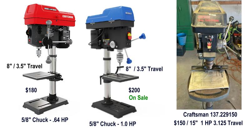

Now that I finally have electric in my shop, I really want a drill press.
I found a Craftsman 137.229150 15" 5/8" 1 HP floor model on Marketplace for $150. From what I can find these were made in the early 2000's, so it's probably roughly 20-years old. I checked Harbor Freight, Home Depot, and Lowes, and the only other good deals I found was a Kobalt at Lowes that's 1 HP with a 5/" chuck on sale for $200, and a 5/8" .64 HP Craftsman for $180.
I like Kobalt hand tools but never bought their power tools. I prefer a floor model and kind of dig having older tools, but does it make sense to spend $150 on a 20-year-old drill press if I can get a new one for $50 more?
You will run out of room on most bench mount drill presses immediately unless you are just using it for wood. Add 3-5" to the table height at its lowest position to account for a good vise or clamp.
$150 for that Craftsman is a good deal if it's in good shape. Open the cover and see if it's clean inside or if there's chunks of belts all over. Run the quill all the way down and shake the chuck around - should be very little movement (none is better!) Turn it on and make sure it sounds healthy. Tighten the table down everywhere and push on it... can you move it up or down at all? Should not be able to.

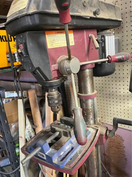

This is the vise I have on my drill press, Vevor makes some cheese dick stuff but this is an exception, I love this thing:
