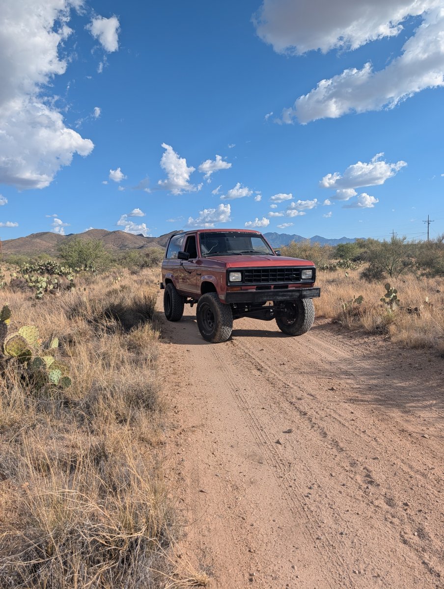

Hey all. Names Kevin. Just got my 1984 B2 a few weeks ago. It already had some work done to it, like the RC 4" lift. It's on 33s on stock axles, so I feel like I'm on borrowed time. Upgrading to a 35 ttb up front and 8.8 in the rear as soon as it gets cool enough to rip them off an explorer at a Pull-a-Part. Planning on a 4.0 swap as well, maybe during the winter.

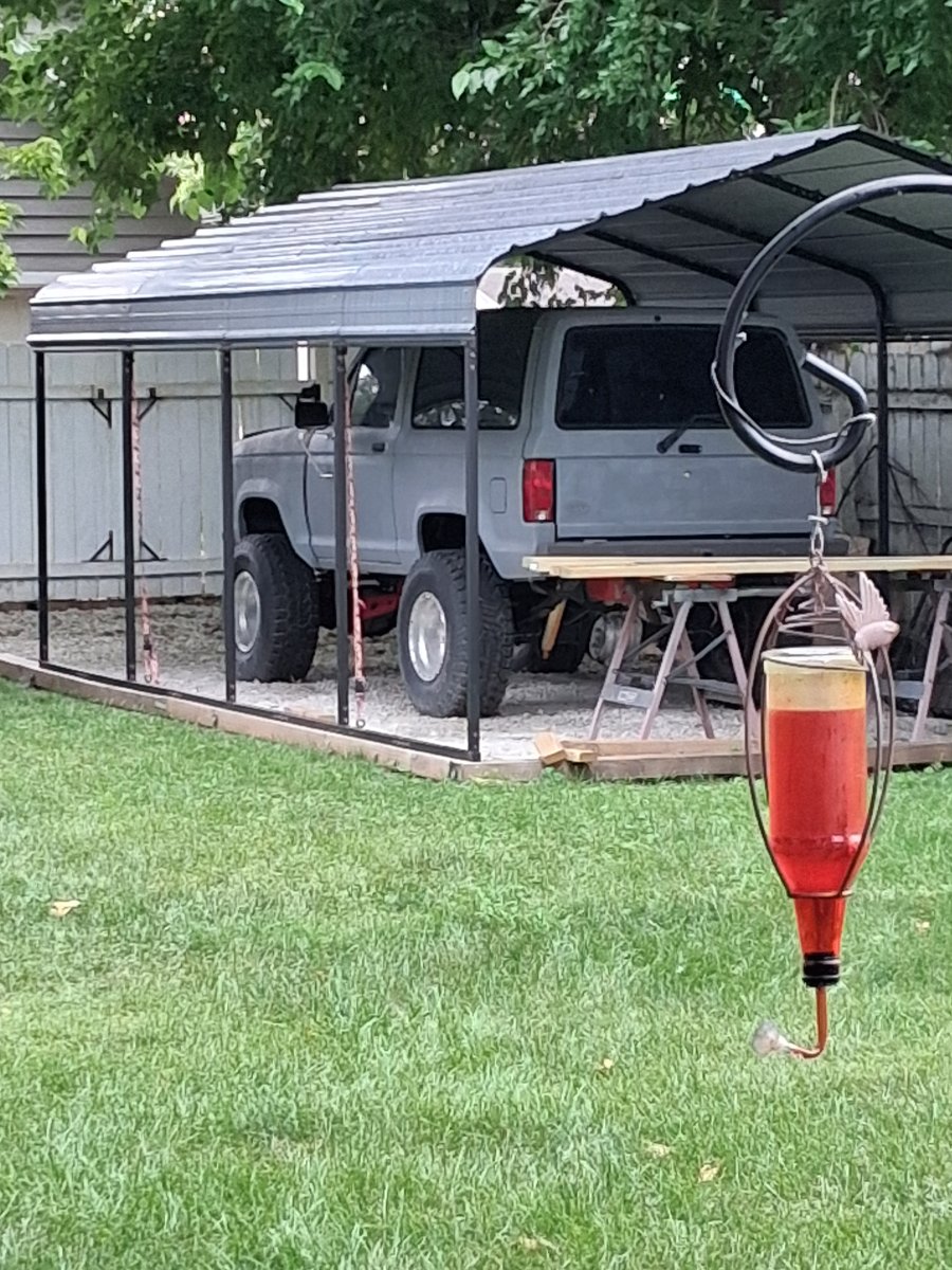

Must be something in the air...
Spent all day yesterday with the pressure washer cleaning up my stalled project.
I have some new found motivation after the clean up and going through my parts stash for it. Also ordered some more tid bits to relocate the TFi when I'm in there doing new Motorcraft injectors. You'd think my wife would have figured out by now that "get what you need"... typically includes things I "want" too.

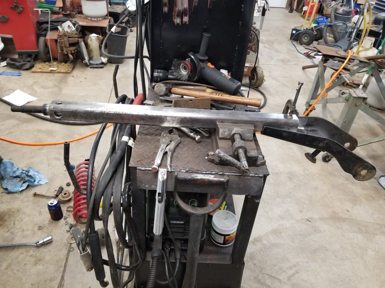

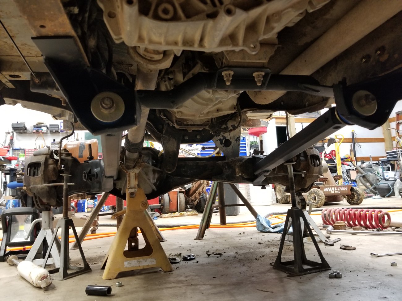

Extended radius arms are a game changer assuming you just have the standard drop brackets for the stock radius arms. What I did was took some 2" square tubing, 1/4" wall and cut off the end to insert into the tubing and cut a section of the arm off then angled the tubing up to fix the caster issues I had. I can post pics later if it would help the visualization...

I’ve done two sets of extended arms now using the 2”x2”x1/4” wall tube and I’ve gone to using Ballistic Fab joints and tube inserts, the second one I also bought a bracket and made what I needed for how I wanted it to interface with the frame and stuff

I have no complaints on the stock bushings, they seemed to work ok for me before and they were in a bind but I designed this setup to be neutral at ride height. I don't remember the amount of travel I figured I had but I think it's at least 12". I think joints with brackets would have been simpler, I just don't like maintenance...
