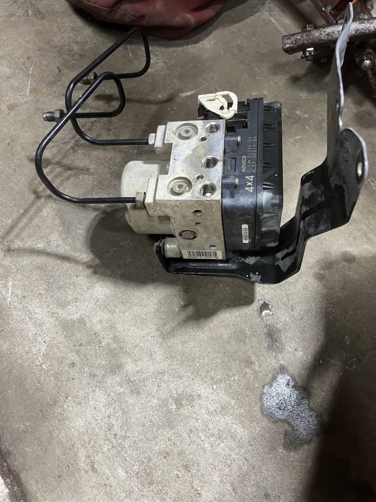

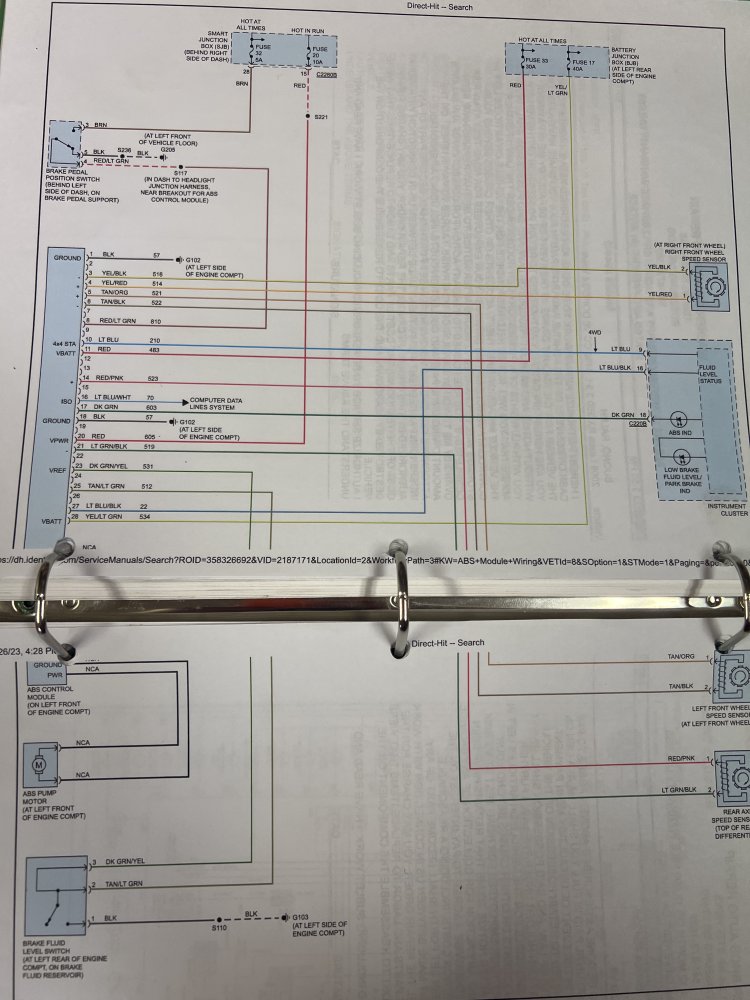

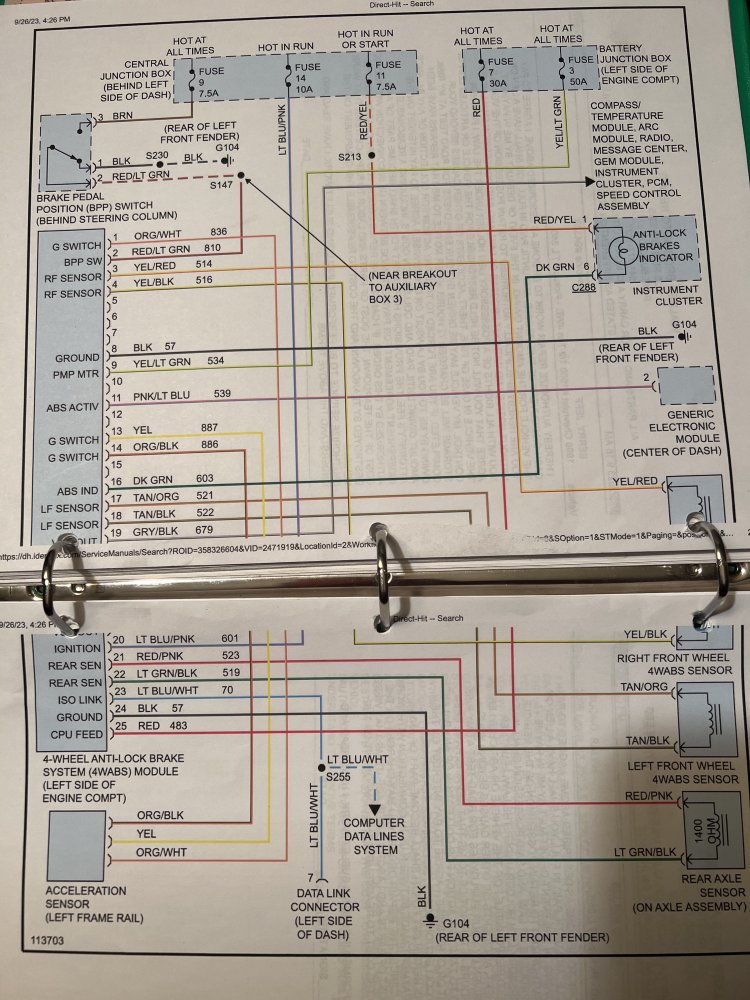

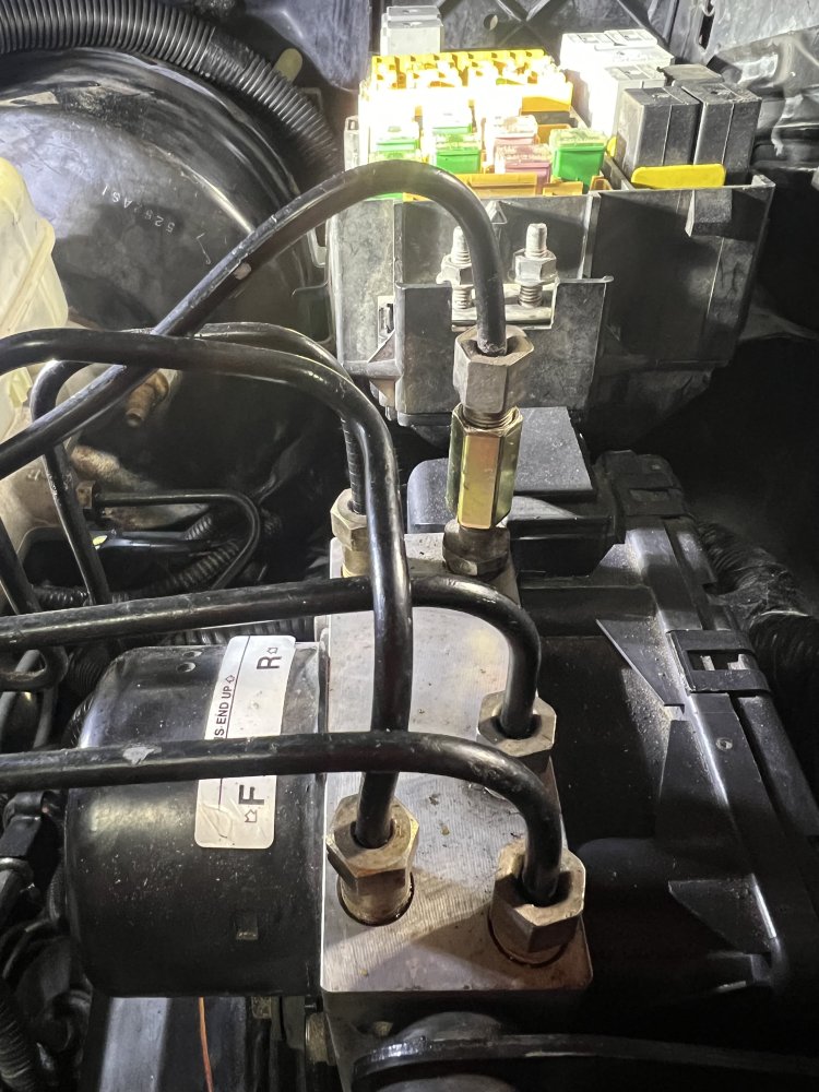

An update: since nobody seemed very eager to chime in I converted my Ranger to the 99 Explorer ABS system. To do that I had to get an adapter for one of the brake lines to screw into the ABS and I had to use the short lines from the ABS to the MC because they screw into the ABS in a different location than the ranger did. I swapped the ABS and the bracket. Then came the time consuming part, I had to solder the 25 pin plug-in + 3 wires for the G-Force sensor in place of the stock ranger 28 pin connector and tap into the gry/blk VSS wire in the C110/C115 plug-in #7 pin and splice the #19 pin gry/blk into it. I got a schematic of the ABS wire functions for both rigs, I couldn’t believe it though, just about all of the wires were color coated the same. There were a few that were different but that’s why I had the schematics. My truck already had the holes drilled for it from the factory. It’s like it was meant for a V8 😂😂. I then extended the wires all the way up to the ABS pump and soldered them to the corresponding existing wires for the G switch that are color coated the same also.
The first two pictures are the original ABS pump in the third picture is the explorer ABS pump installed on the Ranger, you can see that little fitting I had to put on that one brake line I got the part number for that fitting I’ll get it and add it on the thread.

So you used the 4WABS for the SPEED signal(Pin 16, grey/black wire out) like Explorers did?
I used the PIN #19 gry/blk VSS OUT. Pin #16 is Dk Grn and is the ABS indicator on the instrument cluster.
The first one is the Explorer and the second one is the Ranger diagram
Here is the part number of the fitting that I used to adapt a brake line in the picture below
