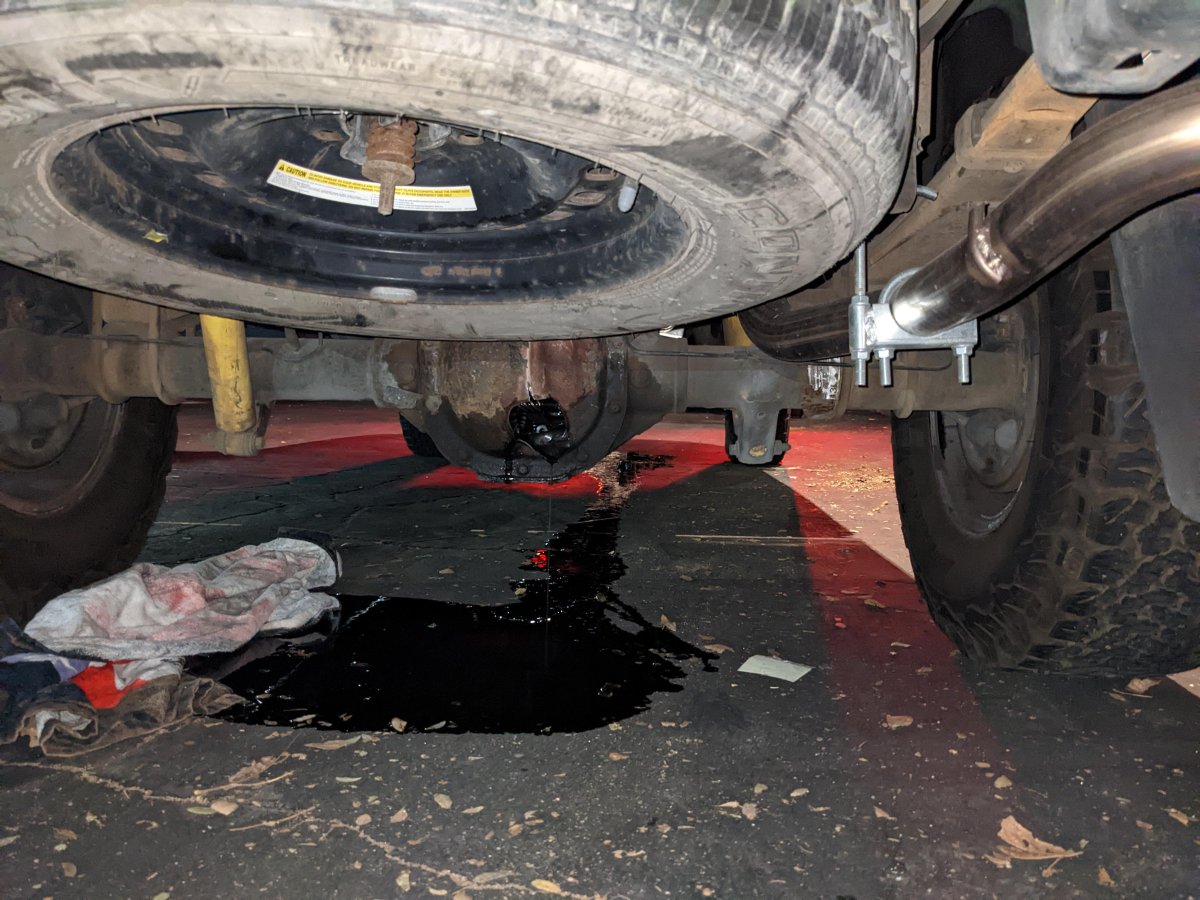

I was happily going down the Freeway when my bad choices caught up to me. Then pow, I hear a loud grinding coming from under my truck so I pulled into the emergency lane. My truck wouldn't move or roll in neutral even. So I called AAA and they got me to my shop but since it wouldn't move I let the guy try to bump it off. To our surprise whatever was seized in the differential broke free and allowed me to roll off the back of his tilted flat bed. And now...
I need some major parts!! I guess ignoring a pinion seal leak is a bad idea.

Wow. Looks like you had quite a bit of oil in it, judging by the puddle? I am guessing something other than oil starvation caused that to happen.

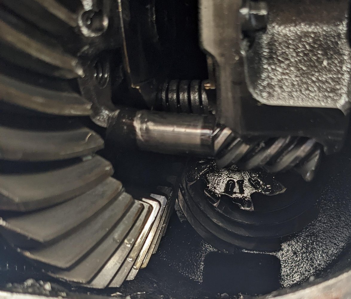

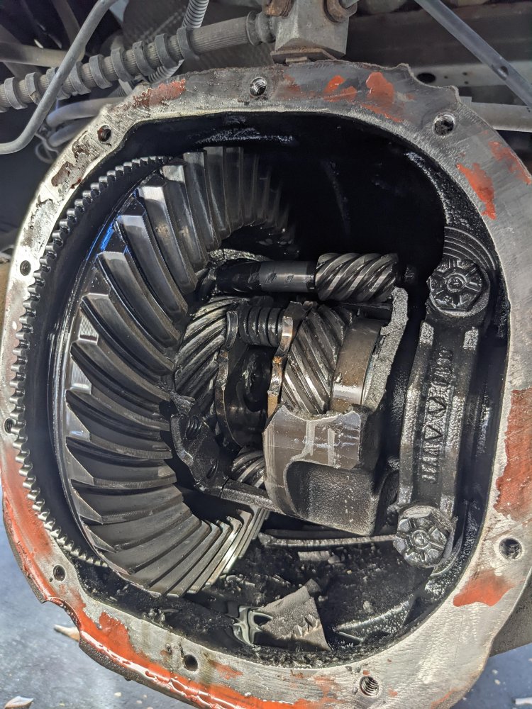

The Torsen assembly blew up! cast pieces and helical gears were everywhere when I opened it up.

I can't believe I didn't upload the main pic! 💥

Yup. Dat’s broke.
There was a recall on those Torsen diffs on 2002 & 2003 models for that very issue, although in their idiocy Ford only applied it to manual-trans trucks. I'm suprised they continued to use those diffs at all after that.
Hopefully upon getting it rebuilt, you'll have the newer (updated) one.
