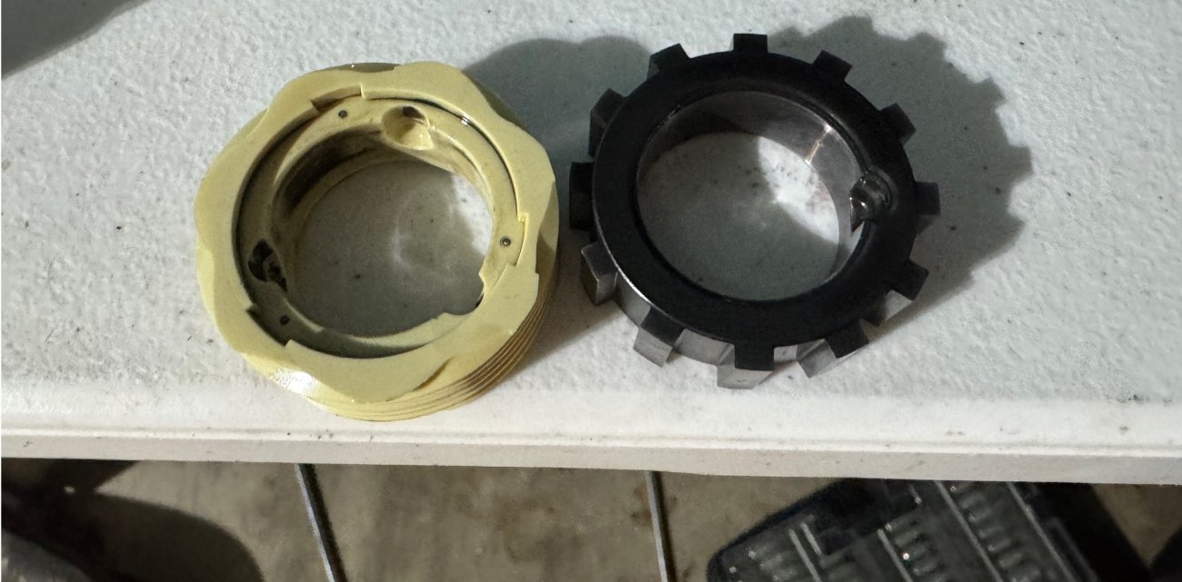

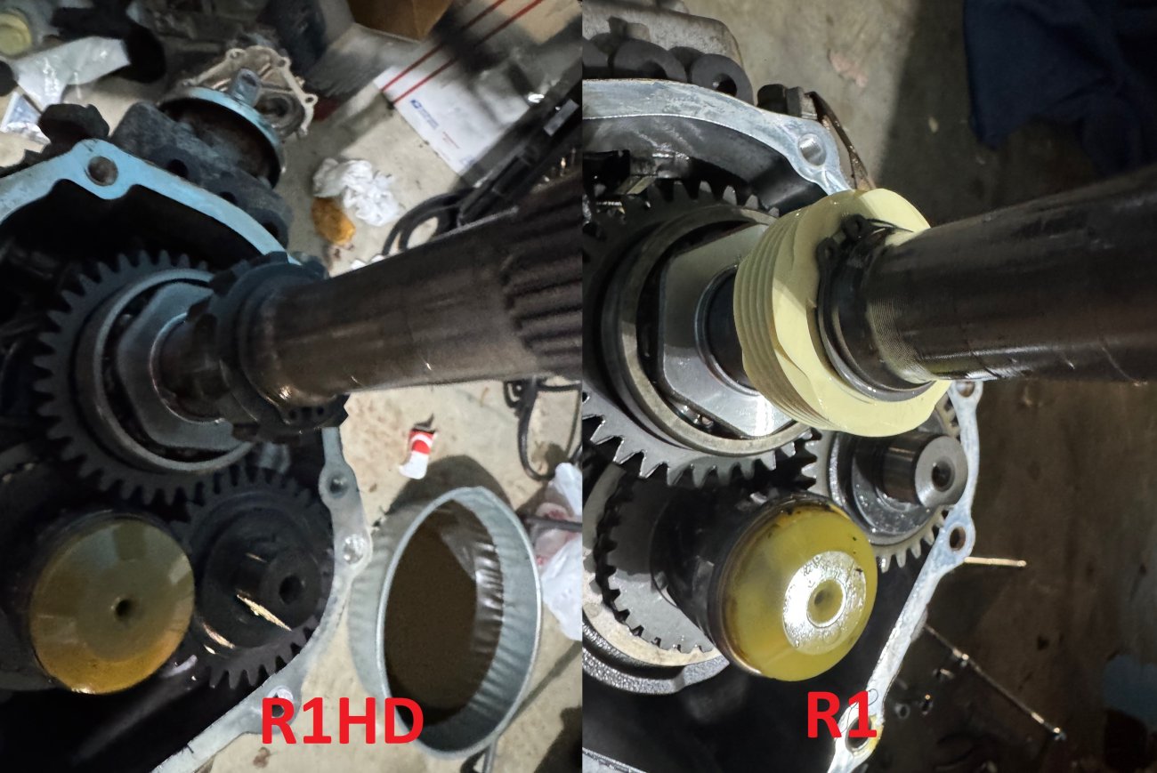

Hey everyone (@RonD), I just wanted to share my experience. I recently installed an '08 M5OD-R1HD into my 1997 Ranger, and I can confirm that it's possible to replace the tone wheel with a speedometer gear. I swapped both the gear and the tailshaft, which is secured by a C-clip. One additional challenge to note is that you'll need to drill out one of the dowel pins since the newer transmission has it positioned on the transmission side.
You'll still need a shifter from a new ranger:
Another thing worth mentioning is that the gears on the R1HD appear to be hardened steel, as indicated by their characteristic discoloration. See pictures:
