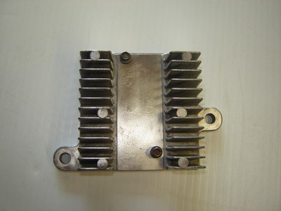

For a 1994 2.3 manual Ranger my ignition module is overheating and has been replaced over and over with the same symptoms (starting up fine, running consistently good until all of a sudden cuts out with total loss of power and then after a short period of time will start back up until the next similar episode which might occur very soon thereafter or just after awhile) - should the ignition module be mounted on a heat sink? And should thermal paste be used instead of dielectric grease?
A heat sink certainly helps...
It is a special grease used when mounting and its not dielectric grease.
