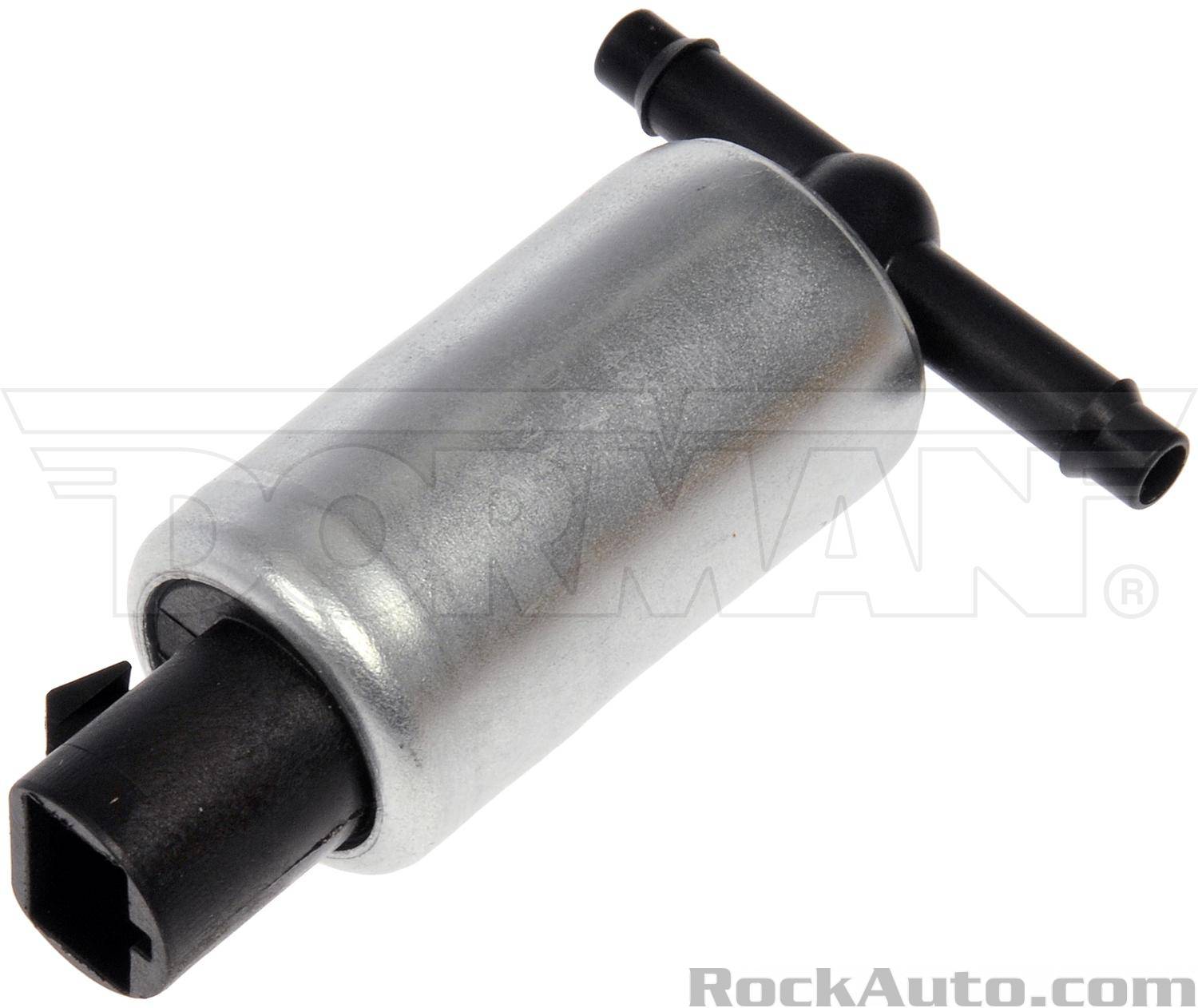

So far I've replaced the IAC valve (twice), and the TPS (OEM Motorcraft). When at temp, all of the tests work... unplugging the IAC, etc. Once warm the thing appears to operate somewhat normally. One new thing I also notices is that before this started, I could be driving and drop into neutral and coast, the idle would drop to 800 or so and stay there. Now, if I do the same, it will only drop to 1200-1300 until I get down to about -10mph, then it will drop to normal idle.
I've tried 2 diff IAC's, one of the cheap Amazon ones, and the one mentioned in another post that I believe is Motorcrat OEM. The one on it now is the Motorcraft one. Changing it has made no difference.

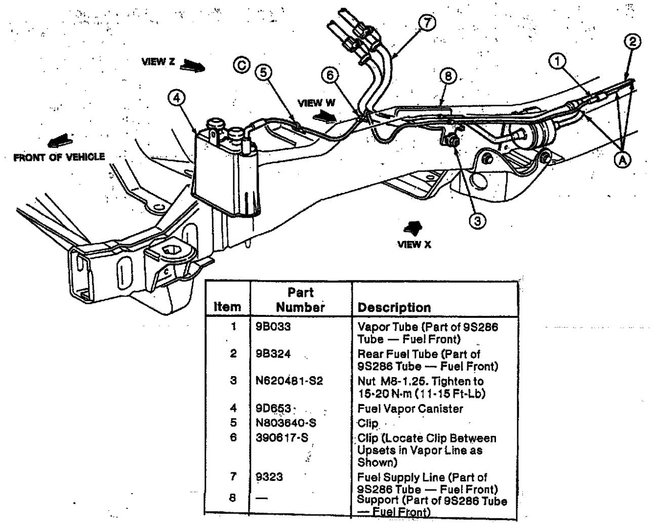

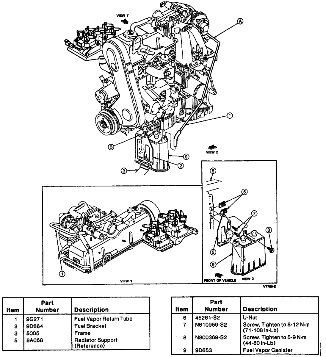

Lastly, smoke is escaping from what appear to be vents in the top of the square charcoal canister that is mounted near the radiator support... and since they are vents (I think), I assume that is expected behavior?
