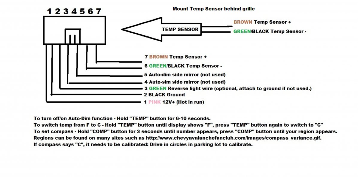

Found a Gentex (GNTX) 455 with both a compass & temperature, it works. 4 wires. Had to buy a new sensor because I'm really new at this whole "GNTX" thing, after hours on the internet elbowing my way around the "ME" kindergarten, I do believe that my local snapa carries these for half of what I paid online. I'll go down there later this morning and see. Other than that it tested working after a bunch of twisting to make the compass functional again. The diagram below is accurate. # 7 & 6 are the RTD sensor's input, polarity is not important....pins 1 & 2 for this mirror are important: #1 is +12v, #2 is ground or -12v (black wire).

Gentex is vague regarding exactly which of (2) different sensors interface with the model 455. There is the GM sensor pn 15035786 (most common & works 100% w/ the gntx 177) and the Nissan sensor pn 27722-1VAOA, which is the one I need. So after a few hours surfing and a reply from the only person that knows and also sells this stuff on ebay "camsmirrors". I got the 177 to work great, but the 455 has only a single pwr button and seems the display is much brighter, just need the correct sensor because it says at 76f it reading 15f. The centigrade reading is 5 below. So my ebay guy set me straight. Seems that there was quite a bit of info being deleted from internet sources, just try asking Gentex's retail company VOXX, "sorry don't support that model". They sell it with no documentation whatsoever! Their new 455 is called the "ADVGEN20A ". Without any prior sales to you, you get zero help at all. They know what I'm up to digging their old stuff out of junkyards.

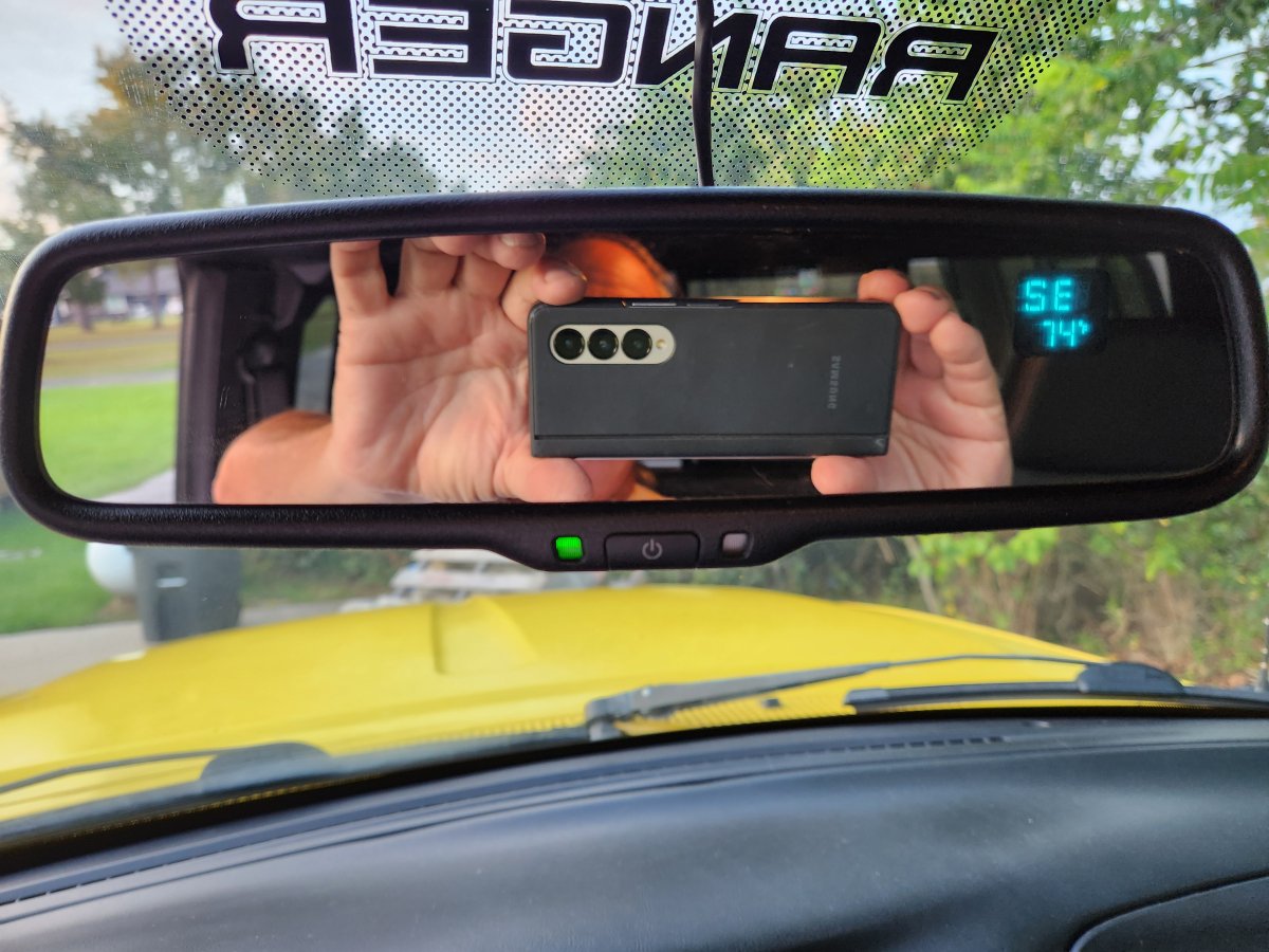

Installed and looking & working good. That Nissan Frontier was recycled, gone in a day...but after looking for anything nissan related, I did find the correct ambient temp sensor.
Pulling off the A pillar trim of course, the mounting tabs were left in the clips- (why fomoco??) Repaired with a thin cut wafer of the same gauge plastic super glued and clamped until cured. Routed the 20 awg sensor wire up to the front grille area, made a 5mm hole and pushed the sensor into it, mounted.

Temp, compass, and auto dimming for a grand total of $60? Hard to go wrong!
