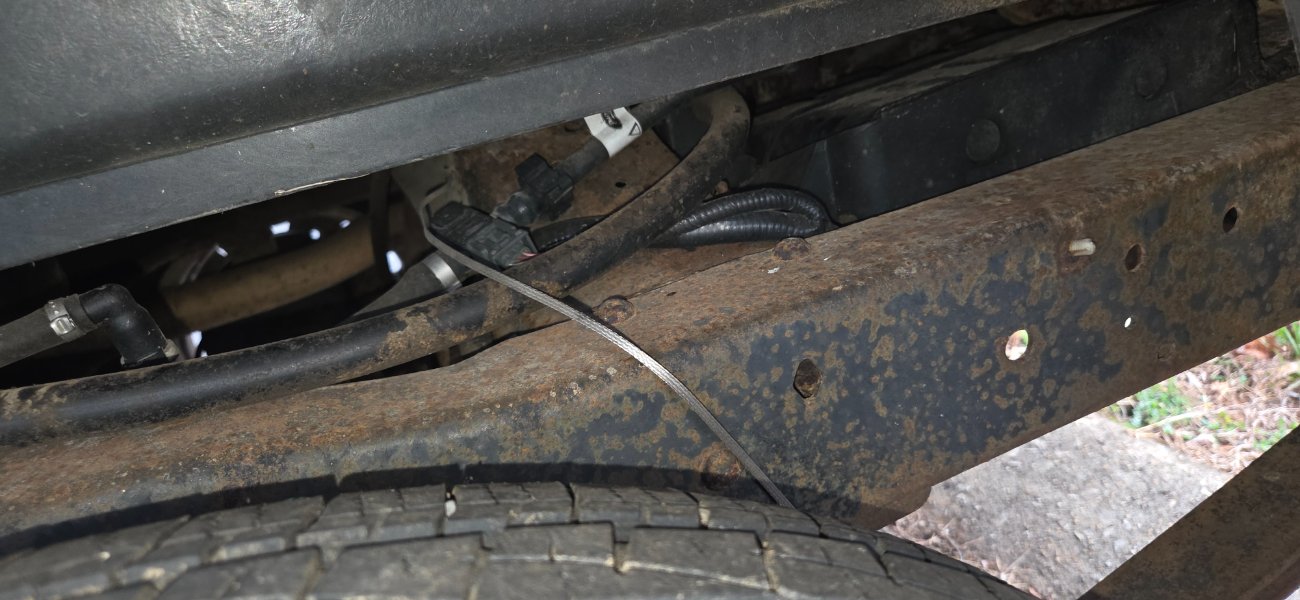

I have a 2005 ford explorer sport trac 4.0 4x4 i have a issue with the truck staying running drove good home hit a few speed bumps and after that truck will not stay running ive replace a few ground straps and just came across this one near the gas tank that was broke would this be the issue with it not running

That doesn't look original to me.
Broken grounds do a lot of weird things. Like Seniornoob said, that doesn't look original. Someone must have had a ground problem in the past and used whatever they could find to fix the problem.

I do not own a sport trac, so I'm speaking mostly from related experience: Yes it can, especially if the ground is meant for the fuel pump.
Example: One of the very first things a new owner of a Renix-era Jeep (Cherokee/Comanche) should is to refresh or replace the ground by the fuel tank because without the ground, the fuel pump may not work, ergo cutting off fuel supply.
At the LEAST, you should REFRESH every ground including that one.
