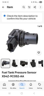

2001 3.0 flex fuel. Troubleshooting my P0455 and did some reading on the fuel tank pressure sensor that clips into the top of the fuel pump assembly. Its accessible on top of the tank, easy enough to replace. Problem is they are obsolete from Ford and aftermarket. I found many that look similar, but fitment says no go. Any leads on new ones? I prefer to not buy used. This Is what it looks like:

Just 3 wires. I'd be willing to bet any other 3 wire Ford sensor for that could be made to work if the mounting is even similar...

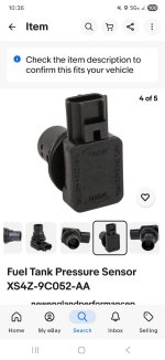

Thats what I am thinking. This looks exactly like the part as well"

Why not used? You will know right away if it works or not. My 2007 ranger is 2.62 volts . Once the evap system starts pulling vacuum on the tank -your voltage will drop. I would definitely go the route of getting used fuel pump for your vehicle from scrap yard if you need the sensor. You are absolutely correct on the fuel tank pressure sensor not being available from Ford. Amazon would be a gamble on this part.
