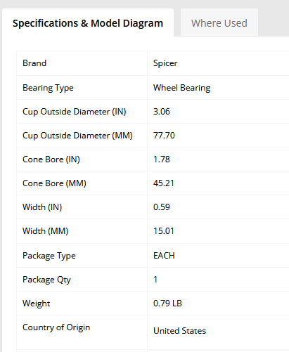

This is the 706110X page directly from Spicer that gives dimensions for the bearings: https://www.danaaftermarket.com/spi...A&cat3=BRG&cp=0&catalog=PIMS_NA&partType=PART

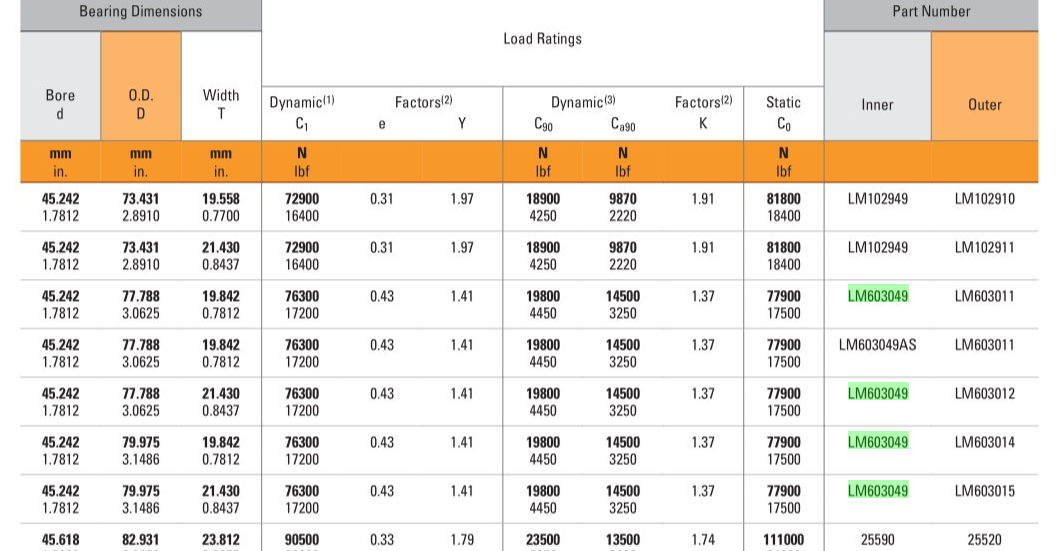

Here is a catalog from Timken that seems to mirror the bearing dimensions, so Set37 from Timken looks to be the same as 706110X from Spicer:
73981

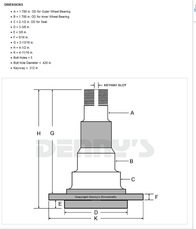

I found this spec list/diagram on a drivetrain website, but since their diagram is a generic spindle, I'm not sure how much this can be trusted:
74274
So B is where the bearing would actually sit (not shown to scale in this diagram, which is why I'm pretty sure it's just a generic diagram). B is 1.78", which is what the Spicer website says the inner diameter of the bearing should be (and is the same as the Timken bearing I pasted in my previous post):
74275
Since I can't find any more specific information on the spindle, I can only assume that this is correct information, and that the spindle and the bearing just have a really, really tight tolerance for whatever reason.
