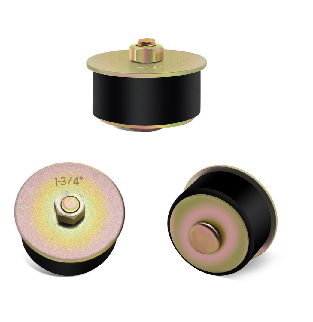

I don't think they're supposed to need sealant. But i'm not 100% sure. They also make a mechanical repair plug you can use that expands when you tighten it. I've never used them. But I believe I have read numerous reports hete that they are reliable.
The rubber expanding freeze plugs have saved me a few times. Make sure they go in square, I had one pop because I didn't take the time to square it in the hole.

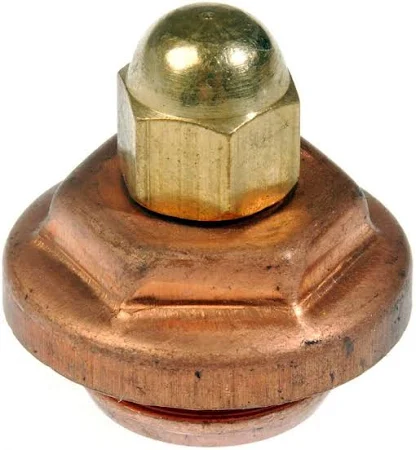

I like the expandable metal ones if the spot is inaccessable.
To be clear, is this correct?
Because this is what I refer to as rubber expandable plug.
