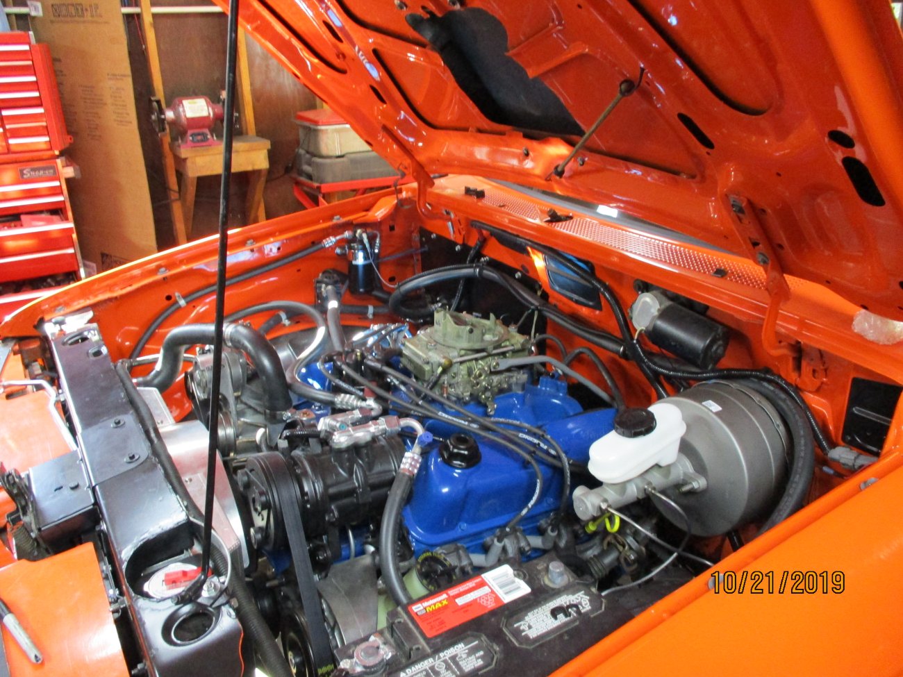

Who has successfully used the Foxbody alternator mount, water pump, timing cover, etc.. in an '83-'93 truck? if you have, or did, please share what you did to make it fit. What radiator was used and were you able to run an electric fan?
use mk7 mounts or comet/eb with spacers to put it as low as possible.
if it is a 4x4 it will require cutting and inverting the oil pan a bit right before the sump.
rework the heater /ac box.
you will want to put the radiator under the core support.
this will allow the universal 25x19 or a durango or jeep v8 radiator and 17 in flex fan or mark fan or taurus fan.
changing water pumps or anything else on the front is a breeze. radiator can stay put.
