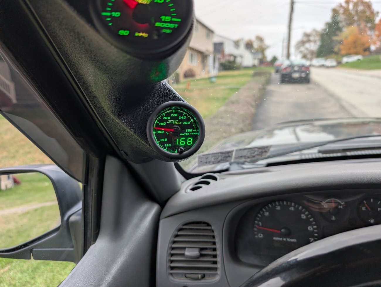

I went with the 175-185 range for the controller. Because i have found out while reading a car scanner, I would find that the ECU temp would be about 10 degrees higher than what the temp sensor would read. Maybe because the stock temp sensors are right on top of the engine.

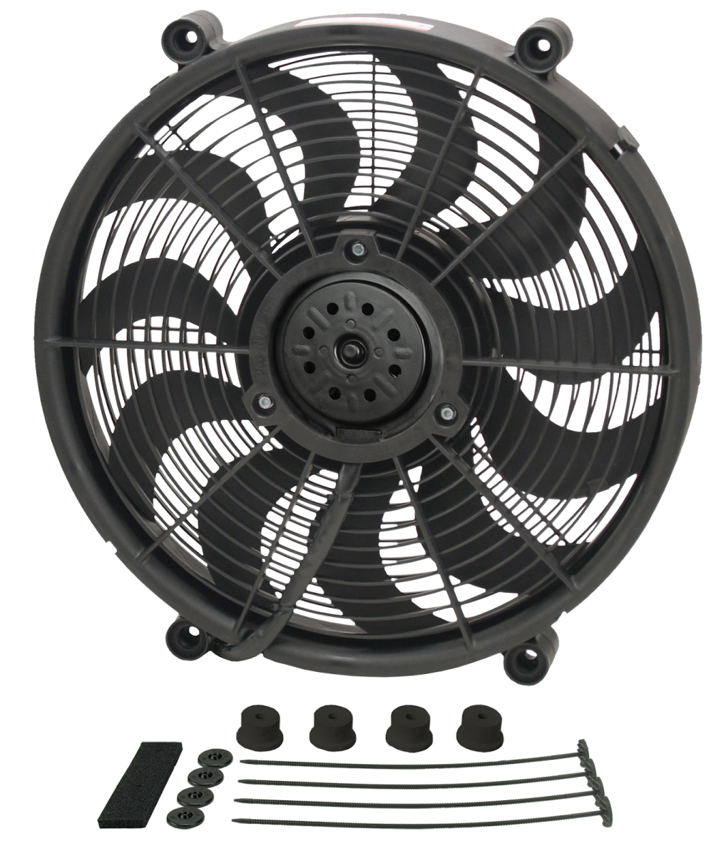

Fan - derale HO Extreme 16917Summit racing. You bolt this right onto the radiator shroud. So you don't need to use the radiator insert holders.

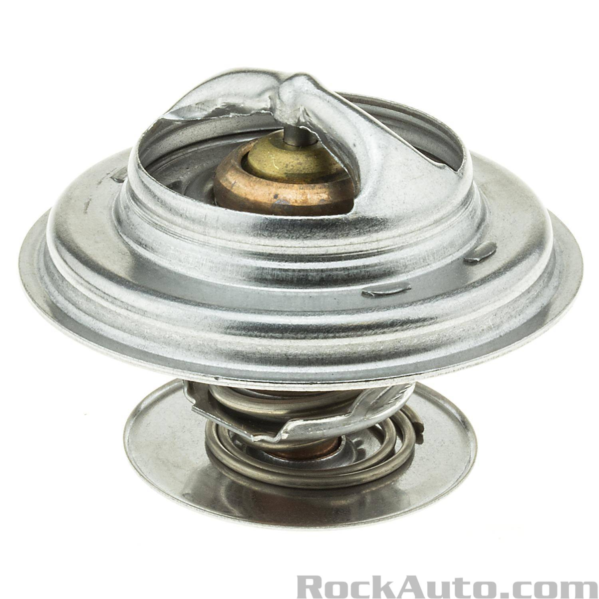

Thermostat - Motorad 248180. 180F. Rockauto. Initially used the 195f, the temp went to high that i was uncomfortable with. Found that the ranger is good at 205 degrees in the tech manuals. The ECU temp is about 10 degrees higher then what glowshift will read.

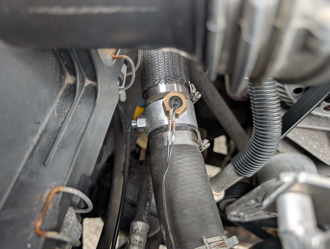

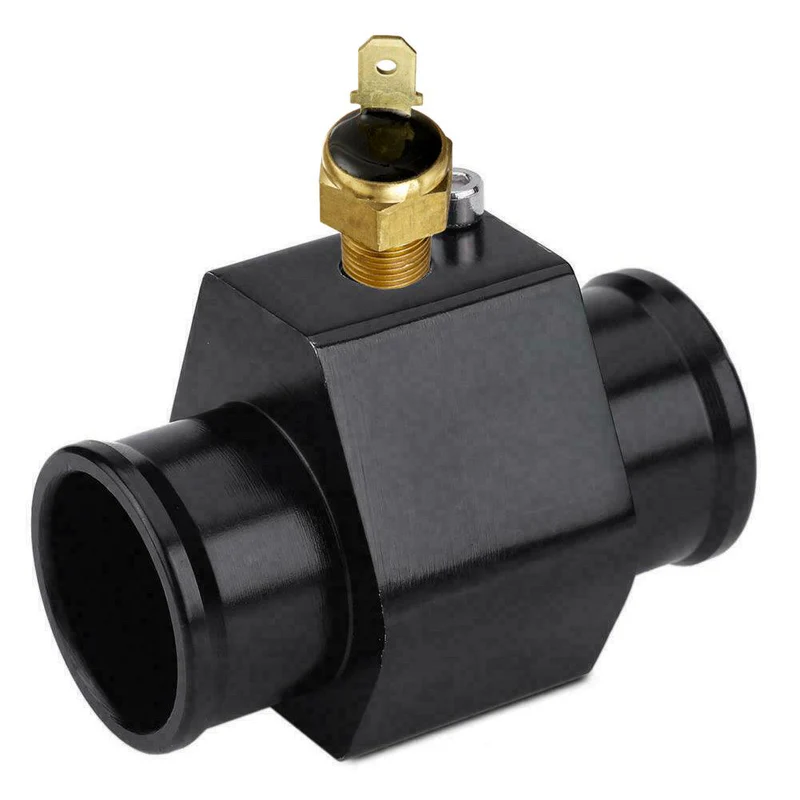

Radiator inline hose for temp sensor - Radiator In-Hose Adapter Electric Fan Thermostat Temp Switch Sensor. Ebay or americanvolt. Used the small hole for the glowshift temp sensor, made a new hole and tapped it for the derale sensor. Cut the upper radiator hose about half way to fit this.
Temp gage - Black & Green MaxTow Water Temperature Gauge. For visual data. YOu can use a scanner to see the temps but i found that the temps are about 10 degrees less of what the ecu was reading

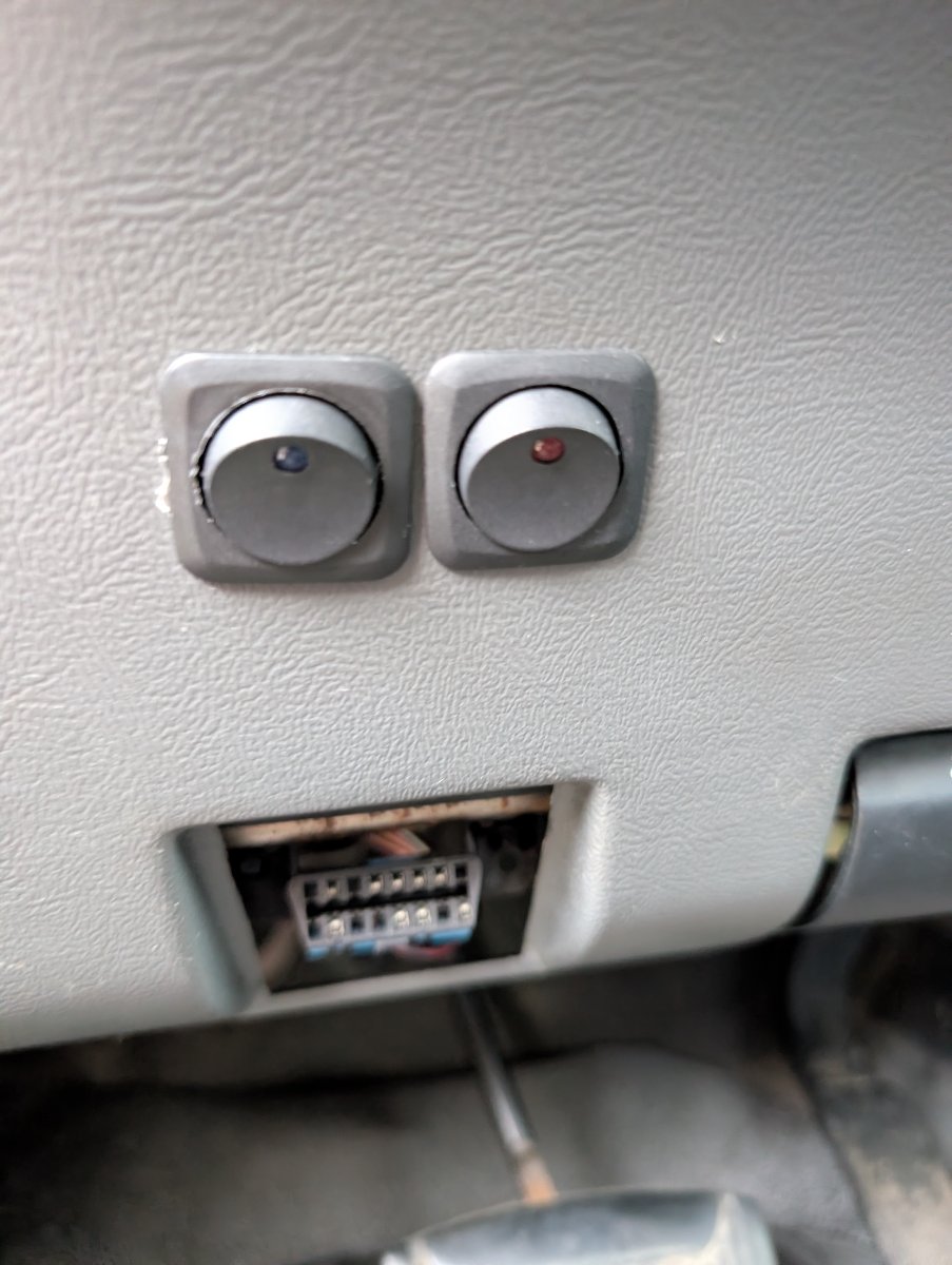

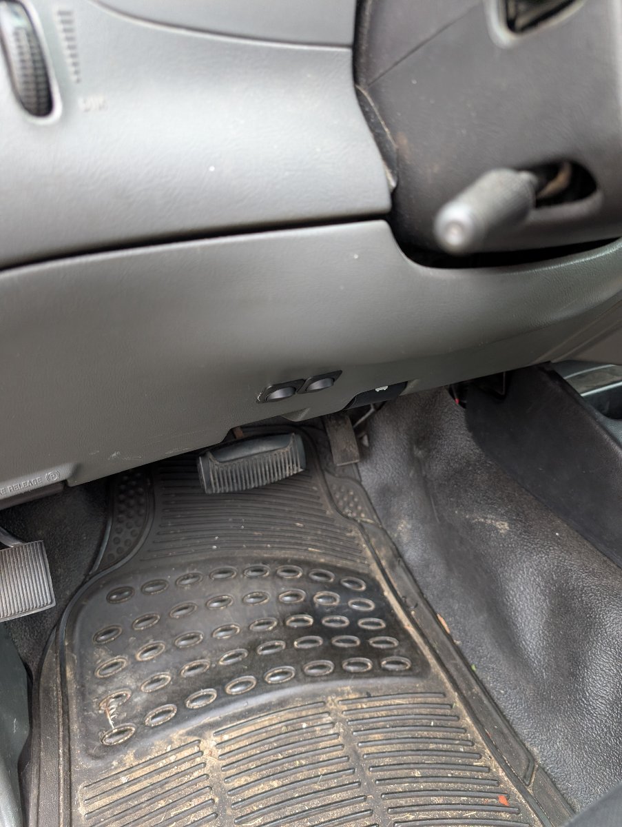

LED Toggle Switch. I chose blue cuz i like blue. But this is the manual switch to turn the fan on. Mounted under the steering wheel

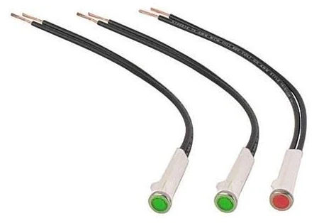

LED Indicator Light- This is for paranoid people that want to know if their fans are running. I can hear the fan but sometimes i second guess it and been thinking about connecting this to the fan to show it being turned on in the car.

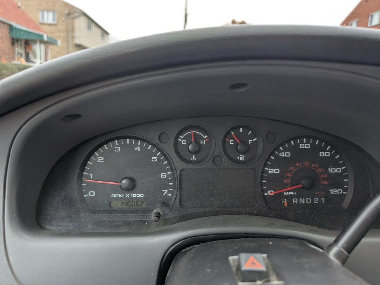

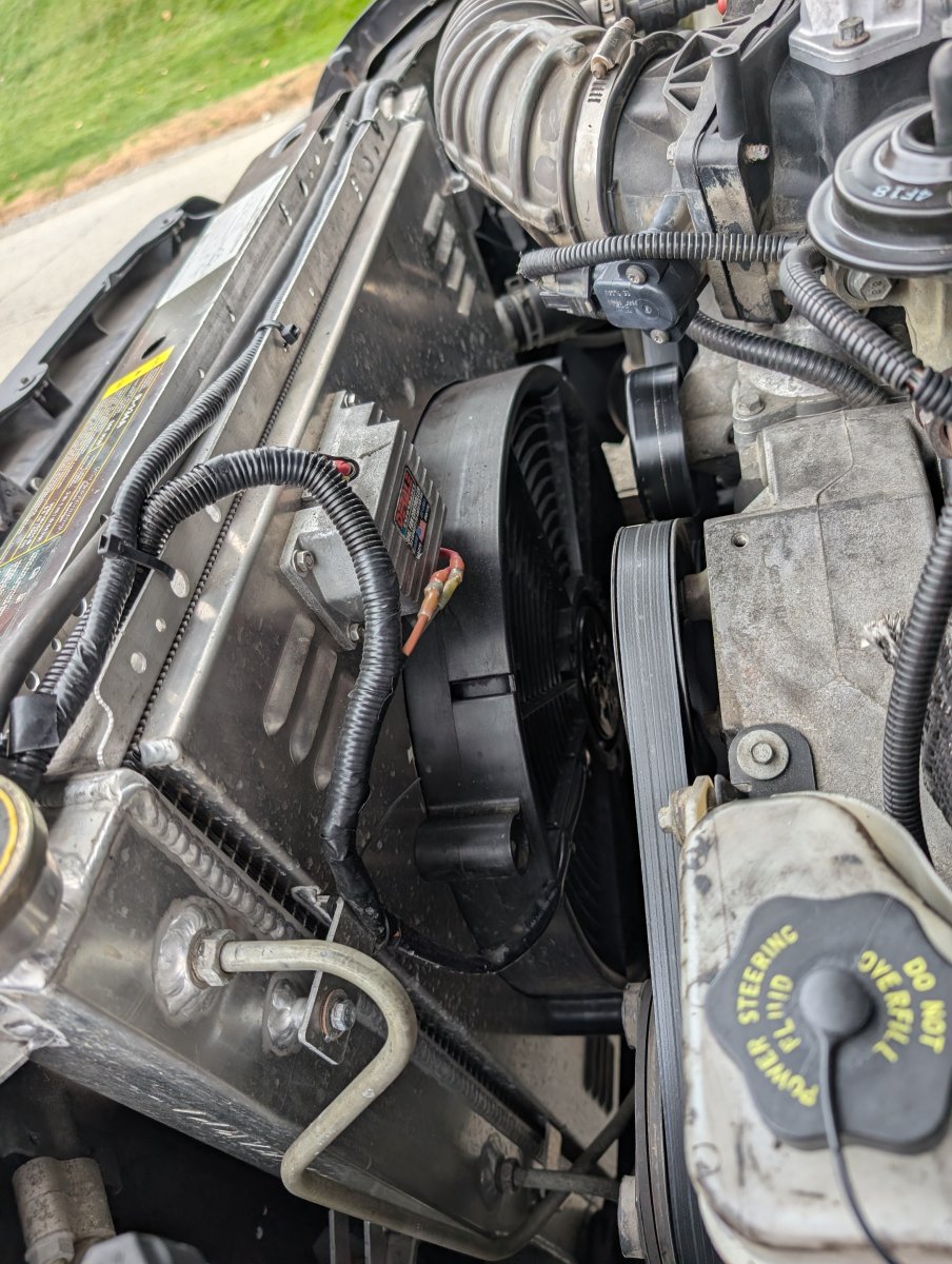

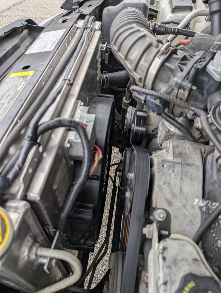

My ending results-
Engine Bay:
Inside the cab-

Inside the cab-
