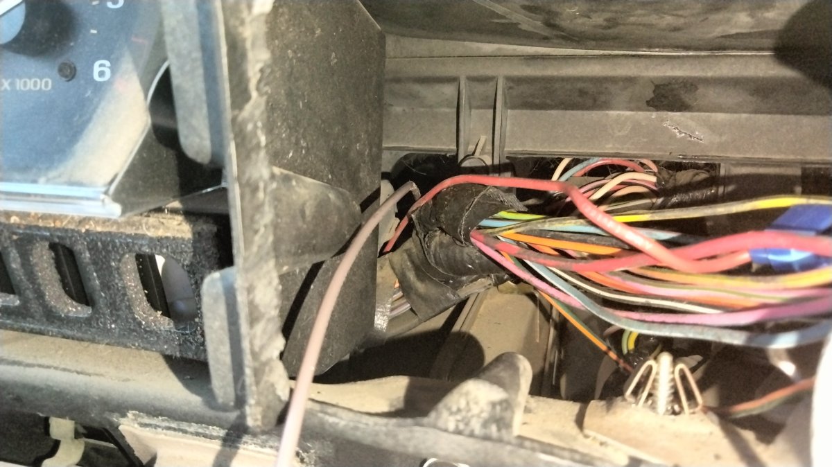

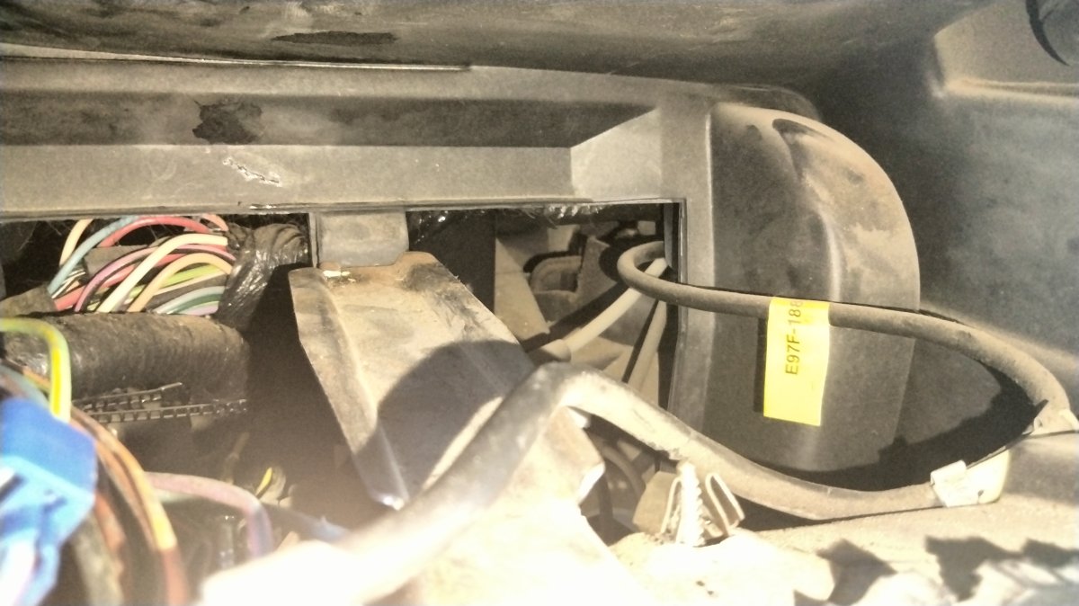

I have a 2nd generation ranger (1990), and am 99% done installing a center roof console (map/compass/temperature) into it. Got everything hooked up except the VSS wire. The guide says it is a pin off the GEM, and the GEM is to the left of the radio inside the dash. Well to the left of my radio is nothing but the instrument cluster, and to the right (assuming right/left reversal) is the climate control cables going off to the side and the glove box (which contains one little mystery item that might be a DRL dummy block).

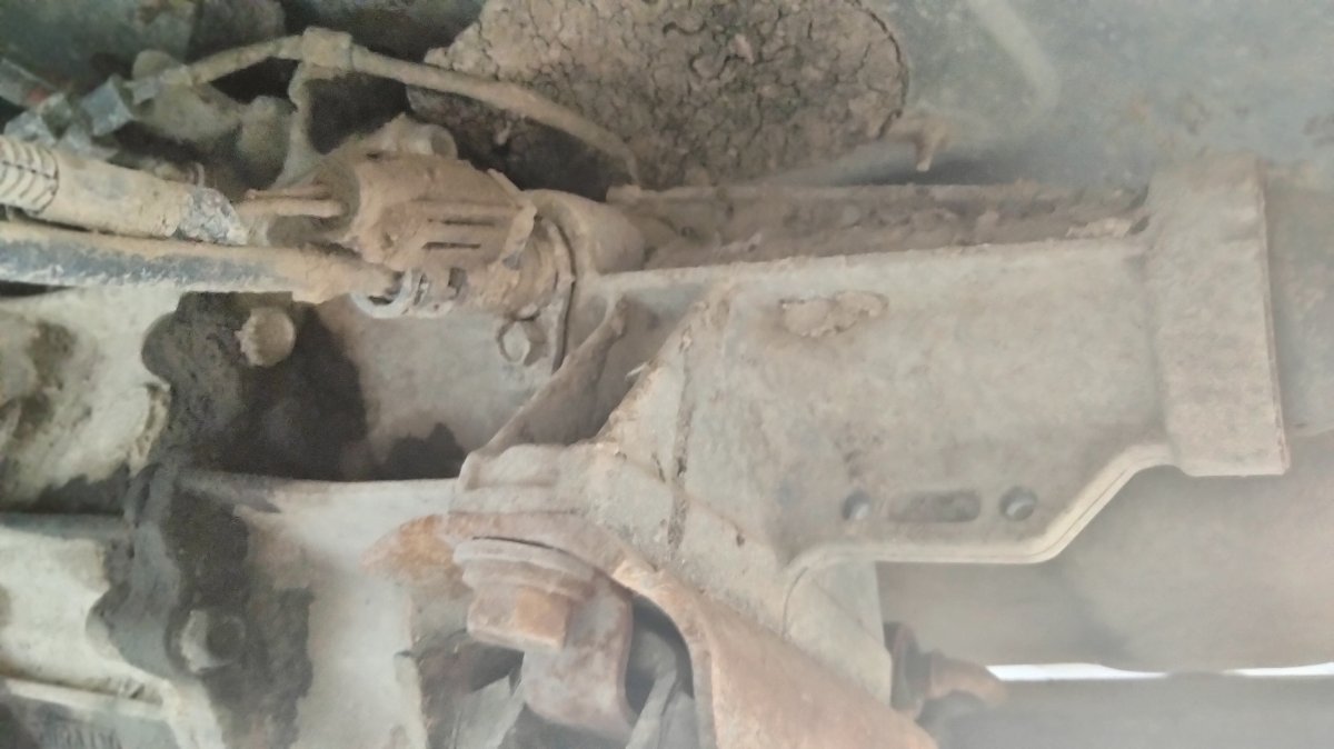

So I figured google around for location of the GEM - all the results I get are 3rd gen or F150/250.... so I look up the part number for the GEM for mine - no such thing I can find. So I take a deep breath and review the basics... it has a MECHANICAL cable driven speedometer/odometer but there is a 2 wire connector beside it on the same tap on the trans, so that wire has to go somewhere and is probably the VSS...

1st pic - mechanical speedo tap and what I assume is a VSS wire:

to the left of my radio (with the radio wires pulled right):
to the left of my radio (with the radio wires pulled left):

To the left of the heater controls and ashtray is a steel box that has a cluster of lots of wires going into it, a 2nd plastic box that has 10 (6+2+2 connector) wires going into it, and below the ashtray there is another module that has 4 beefy 10 ga wires going into it. Absolutely none of them anywhere are grey with black stripe.
