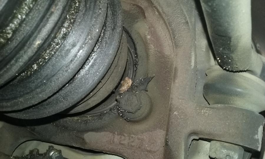

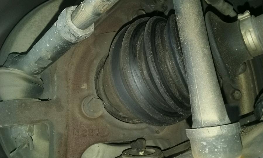

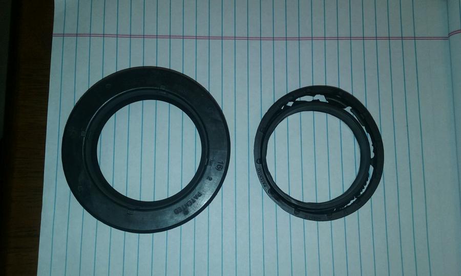

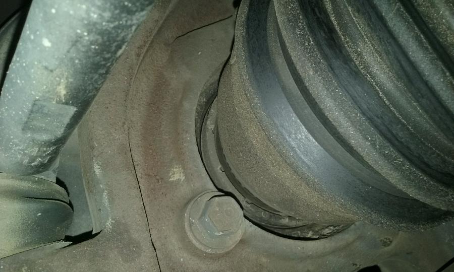

Here are some pix of the area where the seal goes from both sides, passenger and driver's. One side has the seal ripped out and the other its in there. Its right in that gap where the CV axle is going thru the knuckle into the hub assembly. Also a pic of the 2 different seals that are "supposed" to be for the truck. The shredded one is the one that got ripped out and the other larger one is what I bought that appears to fit into the hole in the knuckle. At least that's what the Mazda on-line parts store lists. What's really weird is that it doesn't appear there is one of them in there. I may be wrong because I haven't torn it apart yet. I ordered 2 smaller ones that aren't here yet and are supposed to be like the one that's shredded. This help any? :icon_confused:

Knocked it out. Took like 4 hours to do but got it done. It wound up being the smaller of the 2 seals. Couldn't figure out if the larger one needed to go into the bore of the spindle or not so didn't install it. The smaller one fits onto the end of the CV axle that goes thru the spindle. I'm thinking over time you'd need to pull everything off to expose that seal, clean it up and regrease it. I saw where the little metal ring that's built into the seal could rub against the inside of the spindle and cause the screeching sound so many have complained about. A regrease would most likely fix that if the seal is still intact. If not, a fairly easy replacement. I used a 2" PVC coupler to tap it in place and all square. So we'll see if anything exposes itself down the road. All in all not a bad job and one you could easily do if you have a torque wrench that can go up to 200 ft/lbs and a large enough socket to get the axle nut off. A pickle fork or ball joint remover would help to separate the ball joints. Also highly suggest replacing the axle nut instead of trying to reuse the old one. Its made in a way where its only gonna hold good once. Obvious when you look at it and more obvious when you try and screw in on. Cheers. :yahoo:

They're called dust excluder seals and fit onto the cv axle.
